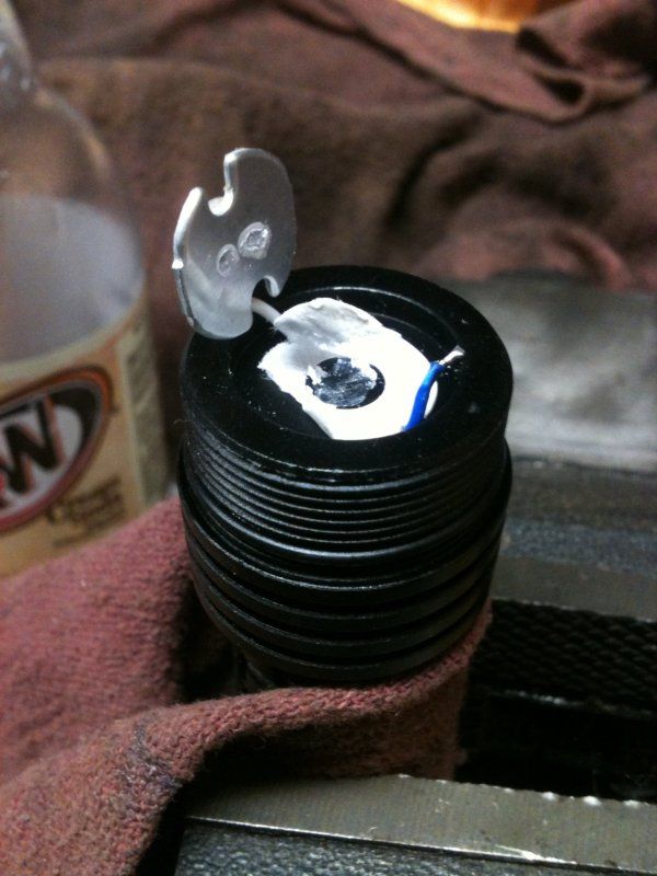

Emitter popped off the heatsink as received and paper "sticker" underneath:
Paper Sticker:

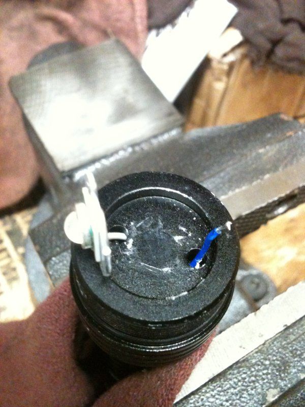

Sticker removed, surface annodized (painted):

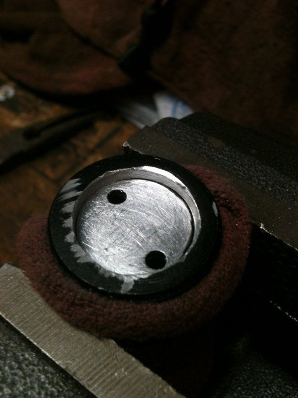

Grinded/sanded heatsink surface for better thermal transfer (scuffed up in the process, but not visible when assembled):

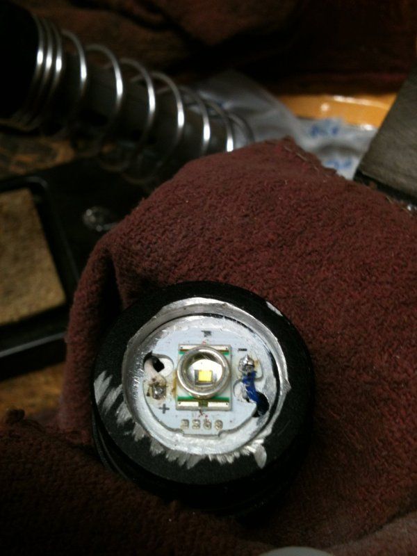

Can accept a 20mm star, but the stock was 16mm (15.88mm):

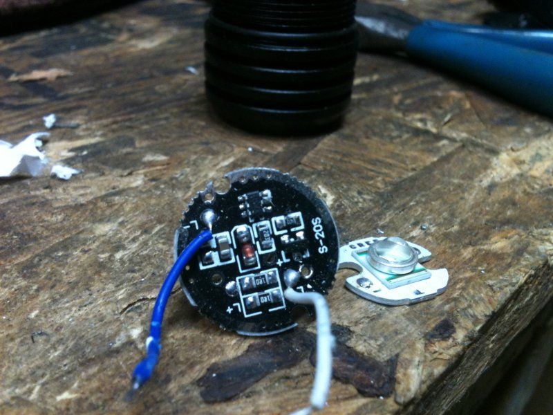

Driver and emitter (emitter on a nice aluminum star):
Driver cavity:

I noticed that the actual LED die (is that the right word for the yellowish "pad") is off center with the dome, almost like it was a "factory second" emitter. It still functions pretty good, but I do see a little bit of a dark spot in the hotspot. I only had a brief moment to try the light this morning. It's definitely a tight beam thrower, but it didn't wow me that much. I intend to compare it to my Dongrui All-920 very soon and will take some comparison beamshots. This A20 is definitely a better build though for only a few cents more.
Oh, and I didn't have to add any shim or anything. The focus still looks good. I tested focus by unscrewing the head and tightening it as I shined on a wall; when fully tightened it was a nice tight spot (albeit with the little dark spot off the side of the hotspot).
