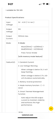

So do I need something like this??
I m okey with using tail switch for on off as my use will be quick few seconds inspection and that’s it.
If anyone can help do I need more parts with this board or just get this driver?
Thanks.

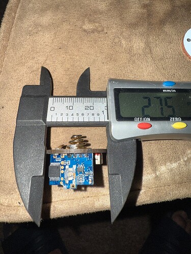

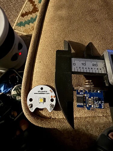

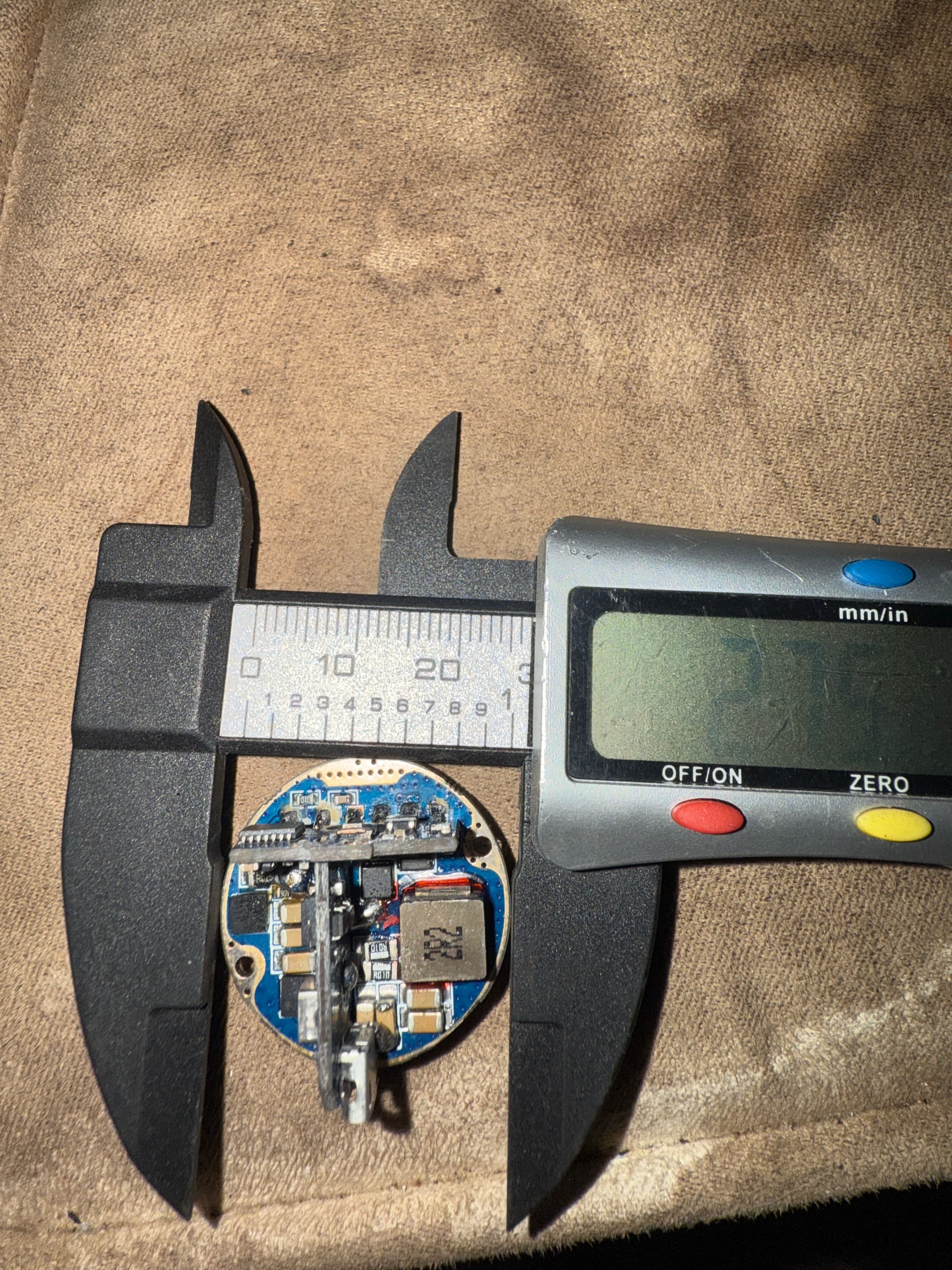

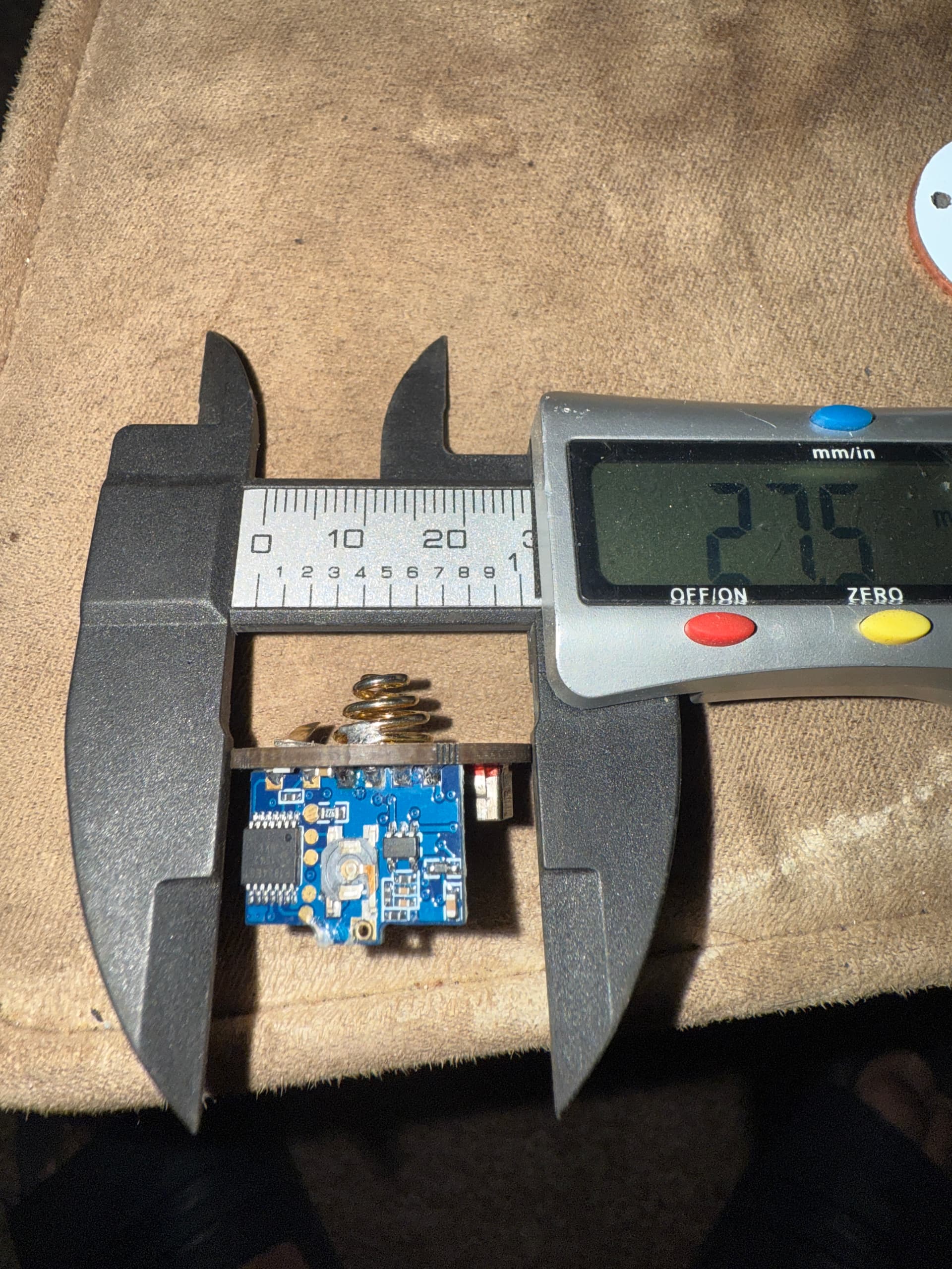

Sorry was busy working,
So yeah took some snaps to give guys and idea what the driver for my beloved L16 measures on the inside,

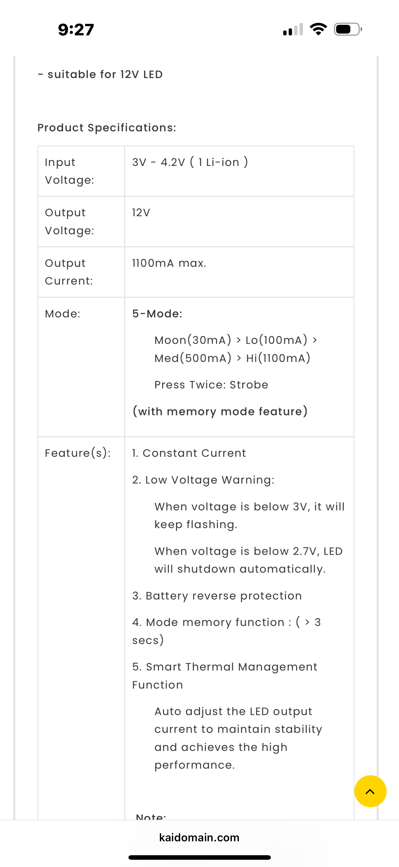

I was thinking of ordering this driver which will power the led from 4v to 12v and then pair this driver with the board that I posted in my first post that 3 pcs which has sub c charging and a micro switch built in!!!
What u guys think???

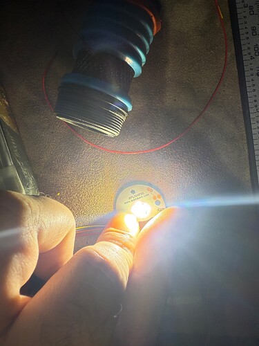

Okey managed to test the led with a stored 3s lipo pack!!
It lights up fine.
