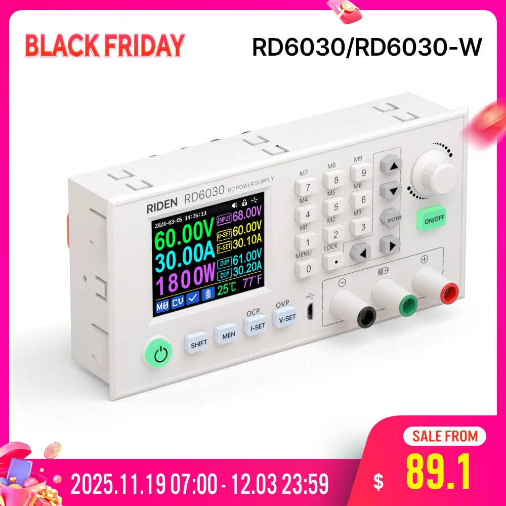

hello, a customer ask me that his new RD6030 are 4-digit display, his old one is 5-digit display, it is impossible, because RD6030 never has 5-digit version, or if you write other firmware to make it, then we cannot take the responsibility if it goes wrong
you may want to know that why a power supply RD6030, which can output 60V or 30A, is only 1440W max output, it is limited by the 1500W PSU inside, now we do not have 2000W 68V PSU which can make it full output

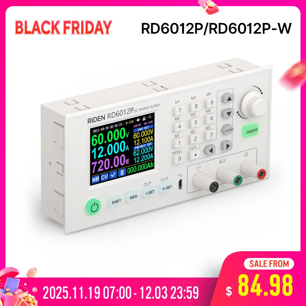

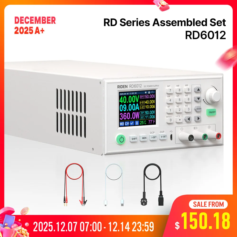

hello, a customer order RD6012 before and he sees there is RD6012P now, he asks if we can provide firmware to make RD6012 to RD6012P, actually the hardware makes RD6012P 5-digit display, higher accuracy, lower ripple

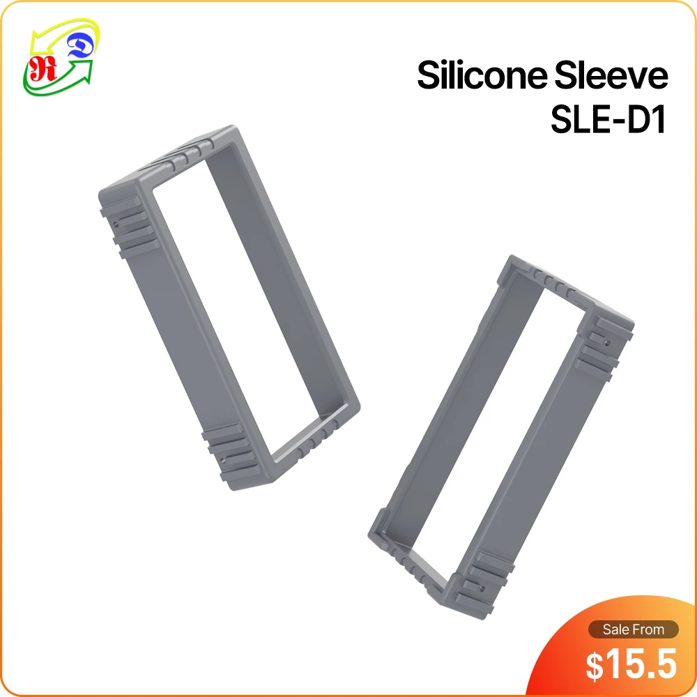

hello, for silicone sleeve SLE-D1, it is designed for S400/S800 case, if you have our early case S06A/S12A case, the size is ok, but you need to add some glue to fix them, because the screw fixing hole position changes

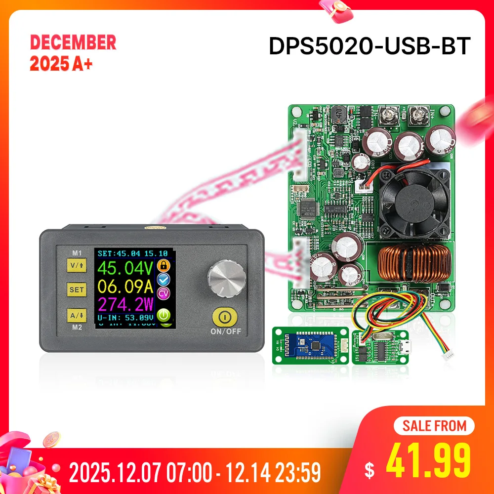

hello, I find that some customers use our DPS(H) series power supply after so many years, the front protection film is worn out, you can contact us for a new one to replace, normally you just pay the shipping fee, or if you order anything else, we can send them together, no need other fee

hello, if you set 60V on RD6030, output shows 60V too, but you use multimeter to check, it is 59.5V(out of allowed error range), then please check if you measure the voltage on the load, there are cables, especially when you use high current, voltage drop is higher
Hello, for silicone sleeve, only RD max version has it, normal RD power supply sets, they do not come with this silicone sleeve, if you need it, you can order it separately, normally when you order the power supply, we will recommend related accessories for it, you can check the message
