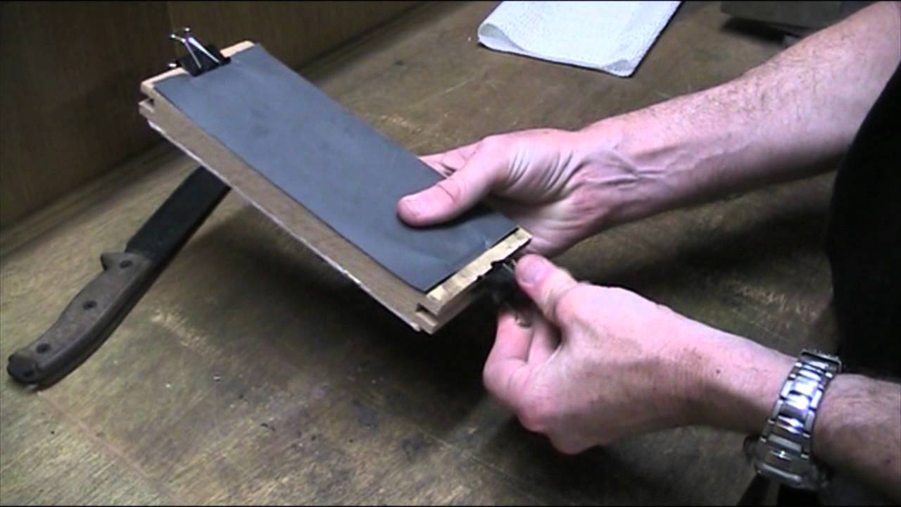

That chip is so minor that it would probably strop out. If you don’t have a strop, a leather belt works fine. You would be amazed how rarely you have to put a stone to an edge if you have a strop and or steel to touch it up now and then.
The nice thing about stropping is it puts a micro convex edge on your knife which makes it less likely to chip than a thin V-grind. Easier to touch up and more durable without any real loss in cutting performance. A thin V-grind will always cut slightly better than a convex edge but in the real world, you won’t notice and lack of cutting ability. In fact, your edge will stay sharper longer so it will seem sharper.

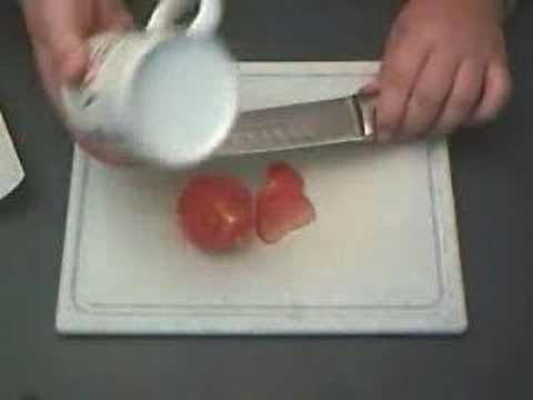

Just get some sand paper at your local hardware store or use the bottom of an old ceramic mug. Use an old leather belt as a strop.

Anyone know where I can get a strop?
