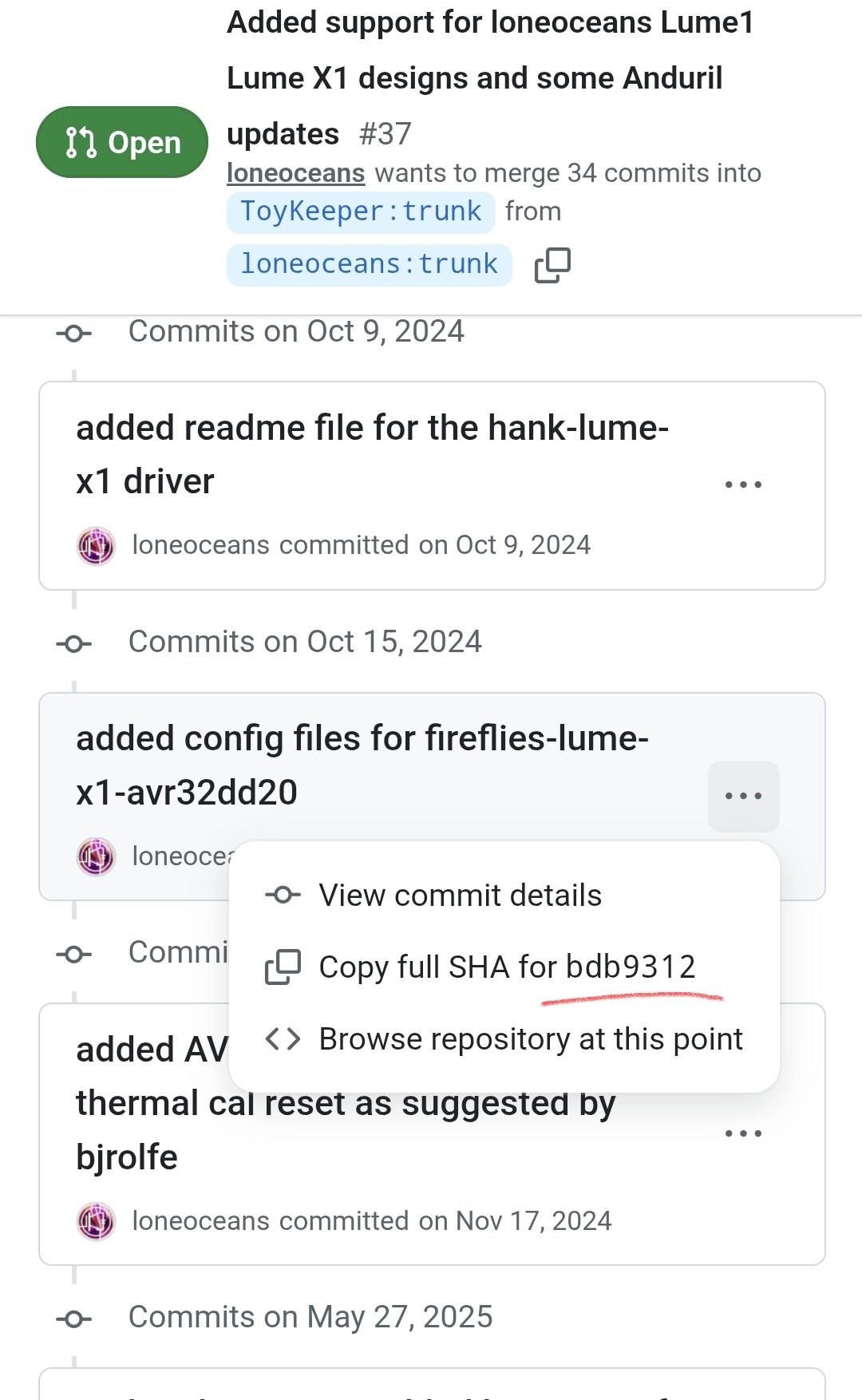

Hi all! Looking for guidance with this. I did a version check and got this: 0462-0—9312. The 0 I think is a very fast blink, and the - are a bunch of very fast blinks (like 5 or 6 in a row). I checked and couldn’t make heads or tails of that, so hoping someone could decipher it. It’s a Fireflies L60 MU V2. Lume X1. Thanks!

“Anduril version check: blinks out HWID + 0 + 7 chars of the the SHA-1 hash of the github commit (letters = buzz)”
Edit: Found that commit

Oddly enough, the version check function actually supports hex digits in its readout. It’ll happily blink up to 15 times per digit. But in loneoceans’ build system, it doesn’t format the version string correctly to get a true hex readout. So the A-to-F digits appear the same as punctuation.
