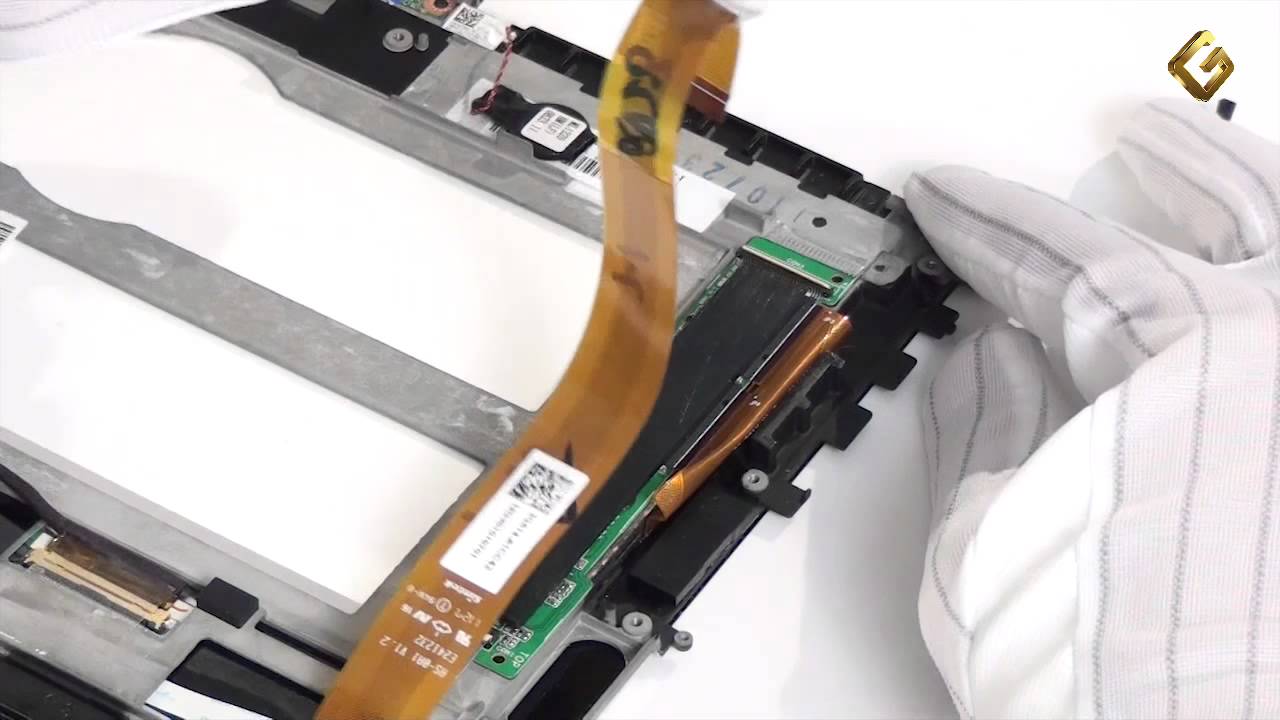

See where your coming from all i can tell is there is a little icon comes up when i plug the headphones in , for some reason the internal speakers just stopped working for no reason i can find , i have been on two or three internet forums to find an answer one directed me to a youtube video showing you how to take a Asus Transformer apart, scary, in the video they add some additional spacers on top of the speakers. You get a close up of the speakers at 9.13 mins with i think the magnet on top where you add the spacer.
