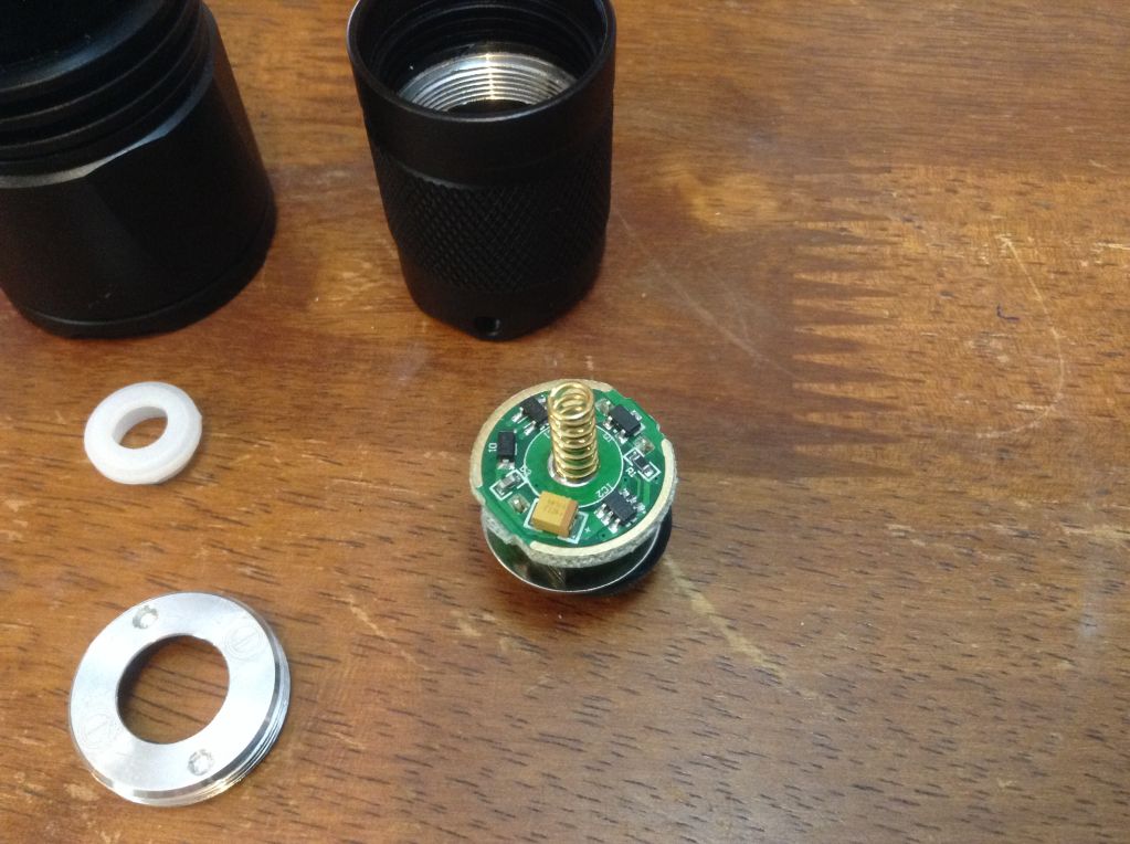

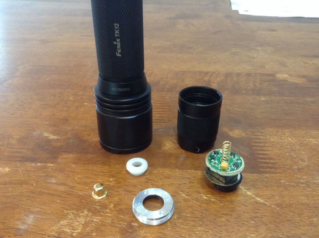

Here is a picture of the Fenix TK12 G2’s tailcap, disassembled.
Here is a closeup of what appears to be the driver board.
Looking down the battery tube, I can see a green circuit board. Unfortunately, Fenix glued the head securely to the battery tube. I haven’t tried to break the glue bond, so I don’t know if the light has a circuitry in the head.
It appears to have a mechanical click switch. It’s more than a momentary switch, as I can have the light off, remove the tailcap, and click the switch. Then, when I screw the tailcap back on, the light will be on. The action feels like a forward clicky when you turn the light on, then behaves like a reverse clicky when changing modes. You have to use the tailswitch to change modes. You can’t do rapid loosen/tighten with the tailcap to change modes, like you can do with most reverse clicky lights.
Thanks for the pic’s.
Now I have to know how the switch works…
If I had to guess, I would say that it is a normal forward clicky plus a momentary contact that is made when pushing the switch all the way in. The momentary contact would change the modes.
