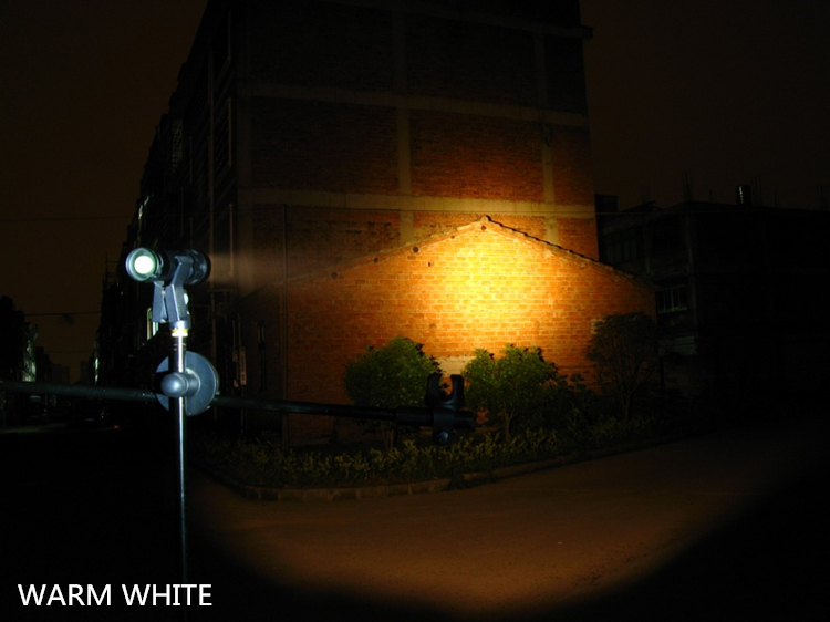

This one emits amber light
CLICK
Way too warm for me.
I took a 3xAAA holder, 3 AAA primaries and put that in a holder so there is no rattle and gave it to a friend.
The pic on the product page is exactly what it did
The 26650 tube was nice to hold, yet I did not use it nor found it interesting wnough for a future review
My friend was very happy though
Website claims that i’s a “warm white” emitter, and the website picture of the emitter looks like warm white
By contrast, an amber emitter looks reddish
That very warm white is probably fine with the original poster’s question — he asked for a color temperature
and some of the warm whites get you a very orange-yellowish color temperature.
