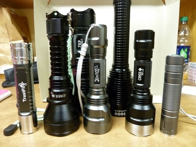

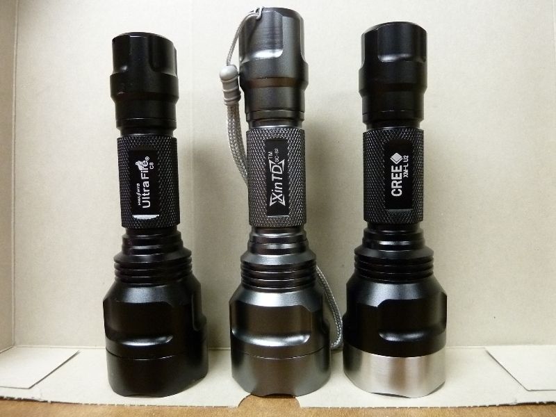

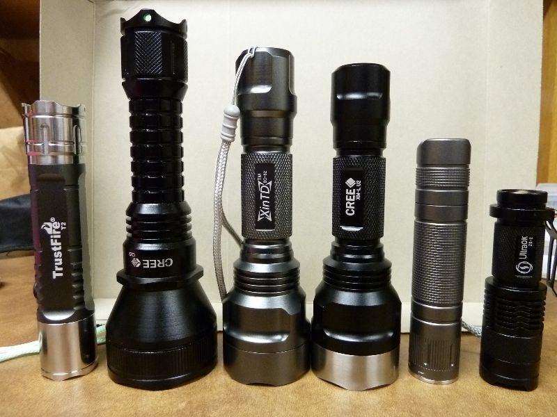

Pics with some of my other lights (jacob, 7G9, J18, 2 other C8's, T2, EDC, SK68 clone). Note the XinTD is longer than most C8's but only because the tailcap is longer - everything else is the same size as the 2 other UF C8's I have:

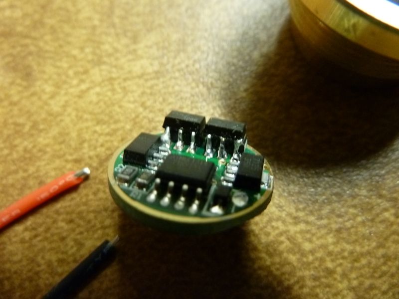

Driver w/2 added 7135's:

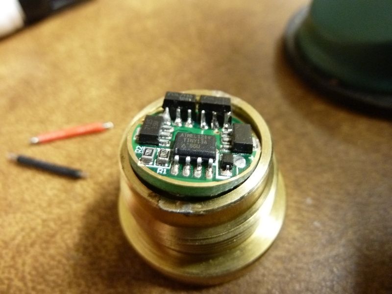

The XinTD pill shown with driver:

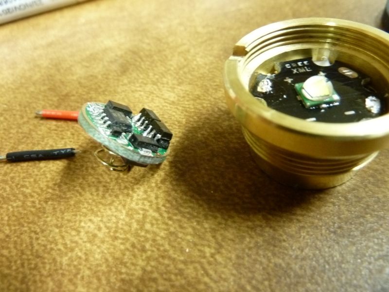

Backside view of driver mod on the pill:
Another view:

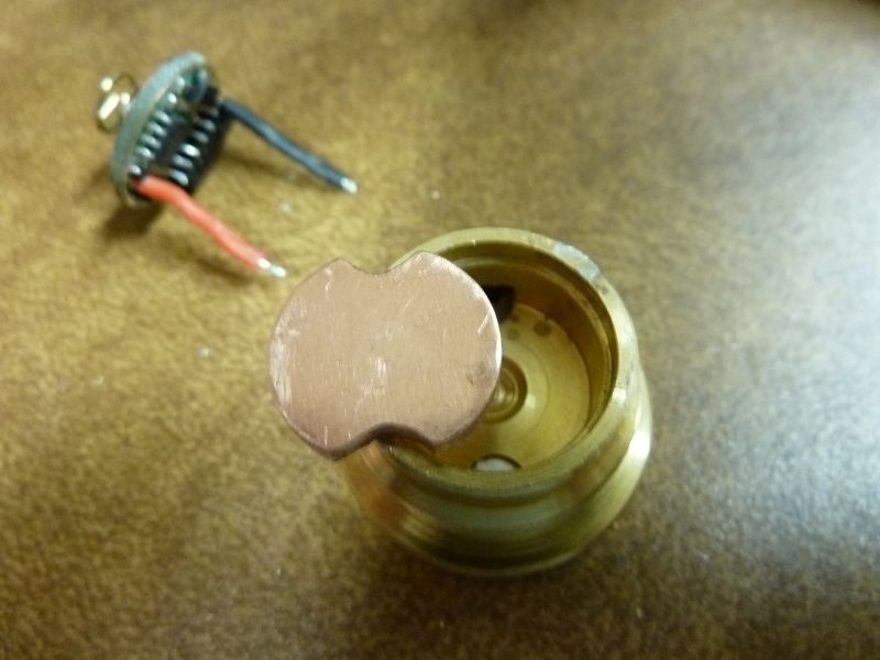

Copper discs, 2 soldered together, w/cutout for wires:
Showing the width of the 2 18 gauge discs (5/8"):

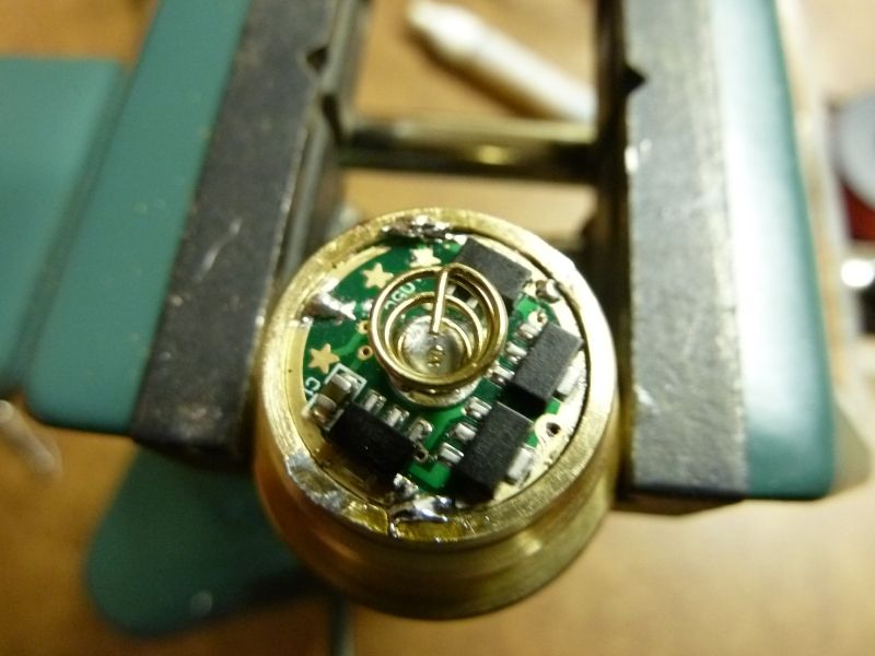

Driver installed w/solder points:
