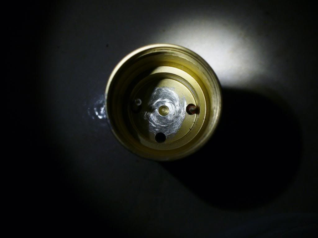

I received one recently from Fasttech and the LED was not attached to the heatsink properly. After removing the LED, what I saw was CONCERNING.
Sorry for the crappy picture.
The small circle/hole in the middle I assume is from the lathe but is a sign of bad machiening. Even my lower quality N-light HB-50 did NOT have this tool mark. Besides the hole, what was worse was that the surface did NOT feel FLAT. It in fact felt slightly dome shaped and I assume this is why the LED did not remain in place. (Thermal paste was used and not thermal epoxy). I tried removing the driver to get free access to the surface to some how flatten it but, could not get the driver out (and broke a 7135 chip in the process) so had to ratch something with the dremel. The work is horrible (because I didn’t want to damage the output wires) but it’s sufficiently flat now.
Ok. thruhfully, I was feeling a little manic after too much coffee and didn’t have any patience at all. :frowning:

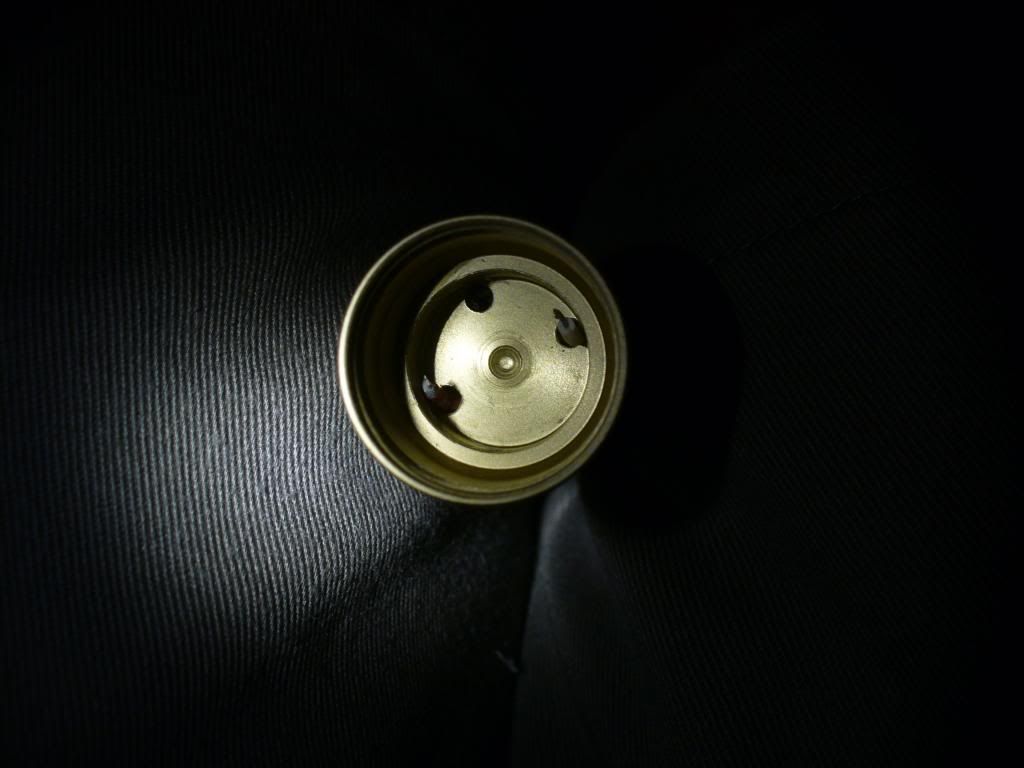

Check out the pic from IOS which was one of first places to sell F12s. How else does yours differ (other than having anodizing under the LED board)?
Bare aluminum under the LED star/PCB
Centering ring that threads down onto the star

Slim, Thanks. That was real cool picking up the bare aluminum under the star in the IO lights (good thing). I didn’t even compare mine… The star of the Fasttech light had a simple ‘butterfly’ spacer to keep the reflector away from the LEDs contacts.
