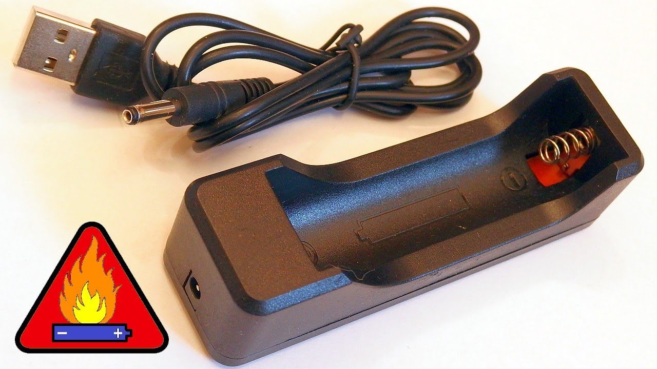

This also only applies to some complicated and expensive chargers. Many simple chargers use the same charge controller ICs as some flashlights. Some are even worse (see video).

The solution is simple. Charge a cell in the light, and the second it finishes charging, pop out the cell and measure the voltage on it.
Later, let it finish and keep it plugged in a few hours, measure again.
Anything less than 4.20V is good. 4.15V or so even better.
Someone reported, but I never got arsed enough to verify, that the infamous Tacklife finishes at 4.1V or so, but if you leave it, a slow trickle pushes up the voltage a bit over 4.2V.
Most other lights use pretty much the same chip and circuit to charge the cell, and they’re pretty much tried and true.
When I get a new light, I’ll put the cell through the Ope to measure its capacity. Later, after it burned off some voltage, I’ll do the above test once, then forget it unless it overcharges.
