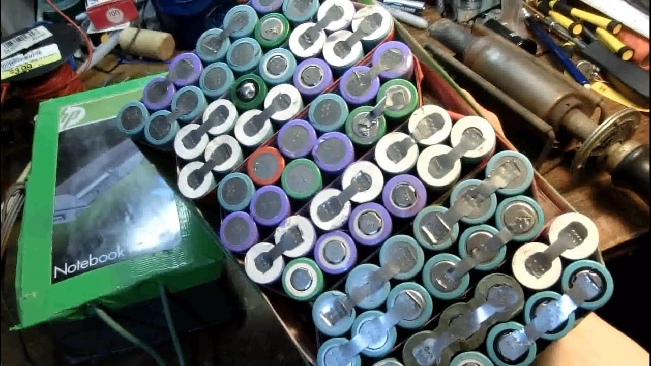

This video made me cringe but he is either oblivious to the dangers or they really are as durable and abuse tolerant as he claims…
What do you think? I realise a cell in a little pipe bomb in hand is more risky than this pack strapped at the far end of his bike but even so…

I skimmed through the video, without audio… (I’m at work)… and it seemed fine except for wrapping the packs in a towel. I wouldn’t have done that. Styrofoam blocks are cheap… would have been a better packing material. And non-flammable.

The only thing about that video that I caught was when he claimed 3.6V is 25% voltage of a full charged 18650. Almost all the cells I have ever looked at data for claim 3.6V is the nominal voltage, which is to say it is the mid range (50%) according to the definition of “nominal voltage.”
I like that he only uses the true battery specs for power from the cell above 3.6V. It gives a lot of overhead so his ratings are most likely on the low end of the spectrum. He claims at the end the bike will go 100 miles after he calculated 200 miles, which is already low because he is only counting mAH above 3.6V.
The main brow raiser was the 0.3VOC reading at 2.15sec in the video. Then he continues to say it’s not taking much power to raise the voltage, a clear indication of high impedance and a faulty cell!
I like what he is doing tho, it’s interesting to see he is using what I would of considered faulty rubbish but getting some use from them, and seemingly safely.

If he would toss the cells below 2V and if he would measure the discharge capacity he could do lot better without using additional equipment and increasing the price only a bit.

He was reading open circuit voltage. Voltage is not a good indicator of charge anyway. What he really needs is an analyser or simply to test them on any sort of load and monitor over time. Even an impedance tester would be a better indication of cell health.
I wonder whether he’s seen a cell “vent with flame” before.

I laughed. I cringed a few times. Overall, I was simply too amused by this farm town super-geek that I just couldn’t stop watching. Obviously a very intelligent guy. Has he seen venting videos? Maybe so, maybe not… but the hundreds of cheap Chinese cells, including many drained beyond the “danger zone” that he’s experimented with are a testimony to the overblown emphasis on the danger of Lithium Ion cells.
The danger is in their being used improperly or in poorly made cell-packs by people cutting corners or not knowing what they are doing. Blaming Lithium Ion cells for fires is like blaming gasoline alone for a fire while ignoring the fact that something had to ignite it. There’s something to flame on… :smiley:

Taking into account rebounding after a short rest, I’d guess that the 25% estimate at 3.6V would be closer to remaining capacity. Almost certainly, the 50% estimate would be far off.
