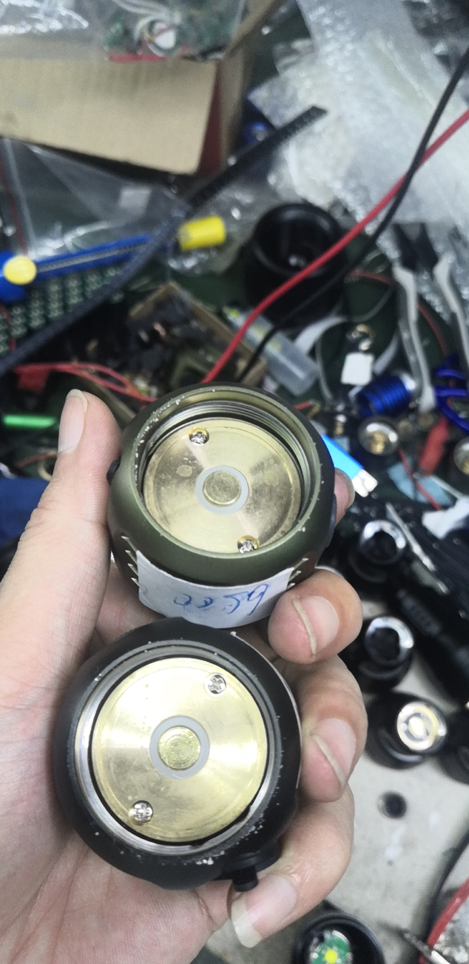

The new mateminco MT07 comes with a brass heat sink,I contacted them on aliexpress. They provided an image, unfortunately i don’t know how to add an image to this post(clicked the image icon but doesn’t work, using an android phone)
You need to upload it to a hosting website and then copy and paste that link into this thread. More info here.
Does it look the same as the one Lexel posted?
I just picked one up two weeks ago from Banggood. Got it the other day. Still the version without the brass heat spreader. Hope they sell it as an extra part one day.
//Does it look the same as the one Lexel posted?//
Yes its the same :v::v:

I am very interested in buying a copper or aluminum heat sink. I would like to but 2 but I’ll take one if that is all that can be had. Only problem is it seems no one is making them anymore. So if anyone would be willing and able to make me one or two I will make it worth your while. As I understand that with the heat sink it’s like a whole new light. Keeps it’s high output for far longer. So please if you can help or know anyone that can help me please message me. I hope to hear from somebody soon. I love my MF01 but it’s so annoying how it keeps stepping down.
The only way I know of stopping it from stepping down without the heatsink is turn on the light put it on high not turbo and let it sit for about a minute and a half. Once the light is warmed up it will stop stepping down at random within only seconds. But to me that is not something I should have to do in order to get proper function.
