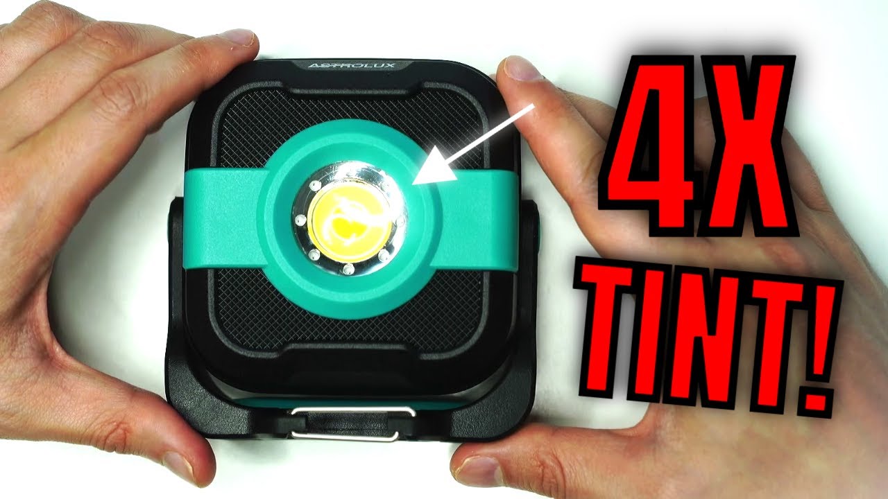

Astrolux WL01: Best Value Multi-Tint Work Light?
Cool light but without a removable battery its a pass.
Might be replaceable. There’s 2x21700 cells inside. Not sure if they are soldered in.
