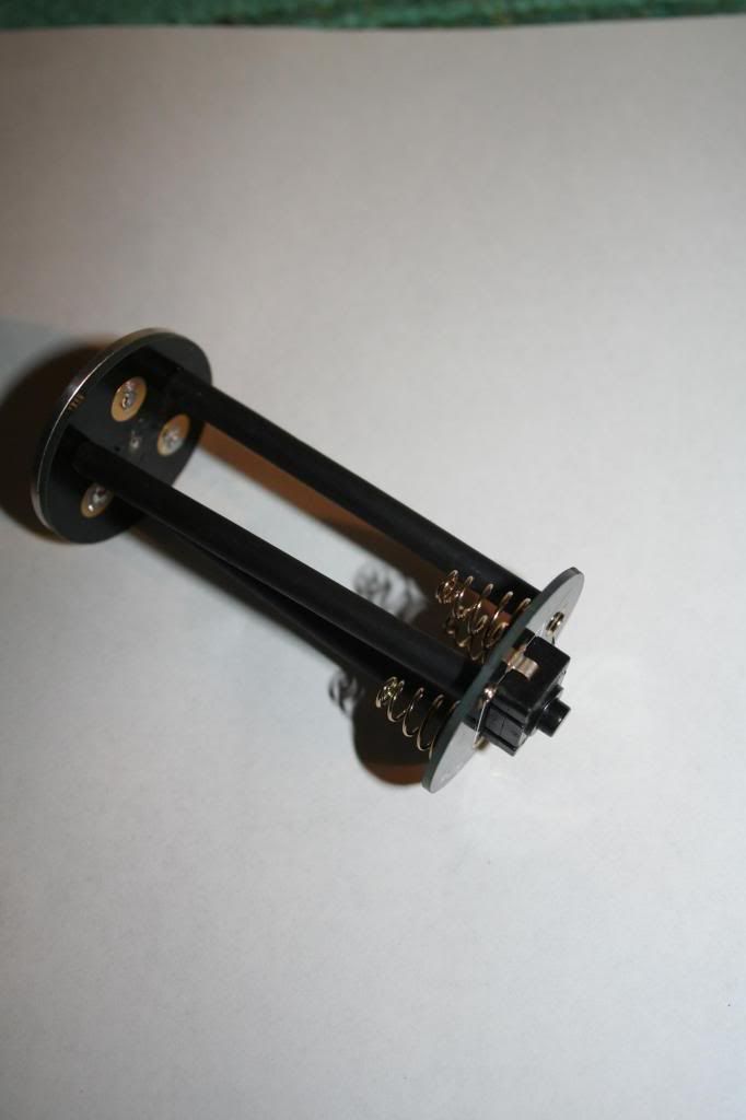

Is there an easy way to convert a 3x18650 battery carrier that is parallel into a 3x18650 serial? That or does anyone know of a good driver for 3xXMl to run on a single battery?

I’d say just pick up the soldering iron and some bits of copper. Or else, just buy the series one ($8 at FF, I think).
This is a picture of it, It's from the new Mystery Sky Ray. The driver in it stinks and I would like to use a DRY driver I have. What I wondered is if it's possible to convert this carrier into series. Do I just take the spring not connected to the switch and move it to the bottom? That seems like I would end up with a short and having it go Kaboom. But I really don't know. So If anyone knows can they please let me know.

Even if it's not a direct swap as-is it's probably less work in the end. Probably less flimsy than the original, too.

Surprisingly the battery carrier is well built that is in this Sky Ray Mystery Machine. Actually a little more solid than the battery carrier that comes with the BTU. Good solid springs, fits perfectly, won’t take the longer batteries though.
Yup, on the switch end, leave a spring on the switch. Put one of the other springs on the other end, and hopefully have a little copper nub to put back.
(And once you’re done, probably not a bad idea to feed it one battery at a time while checking numbers with a DMM.)
Me thinks you’ll spend more time & money on reworking it than the whole $8 a new series carrier will cost you, but again that’s just my thoughts.

Here's a parallel to series conversion:
https://budgetlightforum.com/t/-/5271#comment-101653
Very cool, that is exactly what I was looking for.
