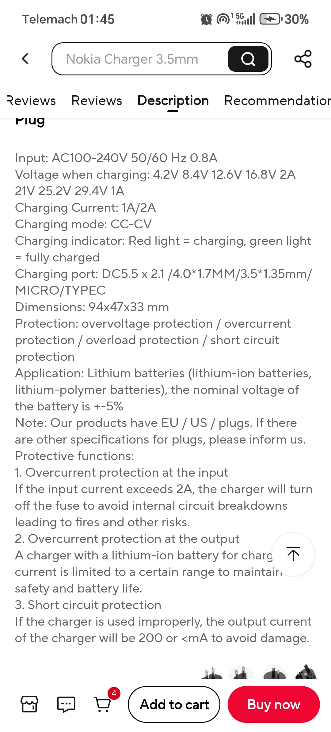

I’m wondering is it safe to charge/discharge the mentioned pack using 4.2V 2A CC/CV charger.
I’m using Dualflex driver board from TaskLed for driving the LED-s.
I uploaded the photo of the charger in the post.
Parallel? Yeah, probably. If true cc/cv, yeah.
Any suggestions on which BMS to put or smth?
Not in the slightest. A bms is for series cells. You can parallel 100 cells and charge them directly as if charging 1 cell.
Typically you do not need bms for single cell charging, but for short circuit protection, or too much load you may want one, which one depends on range of current your project draws
