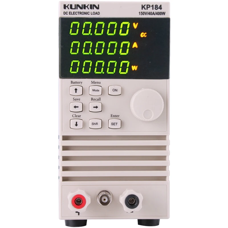

This load can be made for about $30, a finished electronic load (that is much better) is $150 or more (TestController supports some fairly cheap modes: Kunkin KP184, Korad KEL103).
