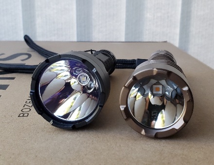

In picture above of TS30S Pro vs T8, eagled eye observers among us have likely noticed how T8’s hotspot is so much larger than that of Wurkkos TS30S. I was (pleasantly) surprised but should not have been. Although SBT90.2 is a much larger LED than SFT-25R (LES 9mm2 vs 2.25mm2), it is paired with a very large reflector, and both size of LED and size of reflector determine size of hotspot.
Just so I don’t get blamed for not pointing this out to potential buyers, yes, T8’s hotspot structure also shows a whitish ring around a central colored spot. This does not surprise me as at least in the throwers that I have (SFT40, SST40, SFT25R, SBT90.2, FFL909MX, Osram), I’ve seen this white ring when SMO reflectors are used. The effect seems worse in super long distance throwers, and more or less disappear with TIR or OP reflectors.
Suffice it to say, in the T8 this effect doesn’t bother me nearly as much as in my two “kings of white ring” :sweat_smile: TS30S Pro w/ SBT90.2 and Firefly T9 w/ FFL909MX, both 1000 meter thrower. T8’s hotspot not a problem to me, especially when looking at nature, vs white walling. But YMMV.

All 3 SFT-25R 6500k lights have a slight greenish hotspot, with a white ring at periphery. This ring probably makes the greenish center more noticeable. But again, nothing as horrendous as some of the bad ones out there, and in real life use for distant target, is much less noticeable.
Convoy LED is clearly from a different bin from Wurkkos. It has a much higher CCT, and the least positive Duv. That said, the difference among the 3 tints are subtle as seen in picture below (better seen in my OLED computer than in the one with LCD), with Convoy T8 best, and TS15 worst, by either eyeballing or measurement.
Again, I love all 3 lights, but, outside of the bigger size, Convoy T8 6500k gets my recommendation. Not just for the LED, but also for the buck 5A driver. If you want a 14500 + AA thrower in either 6500k, or especially 5000k, Convoy T8 is an excellent choice IMHO.

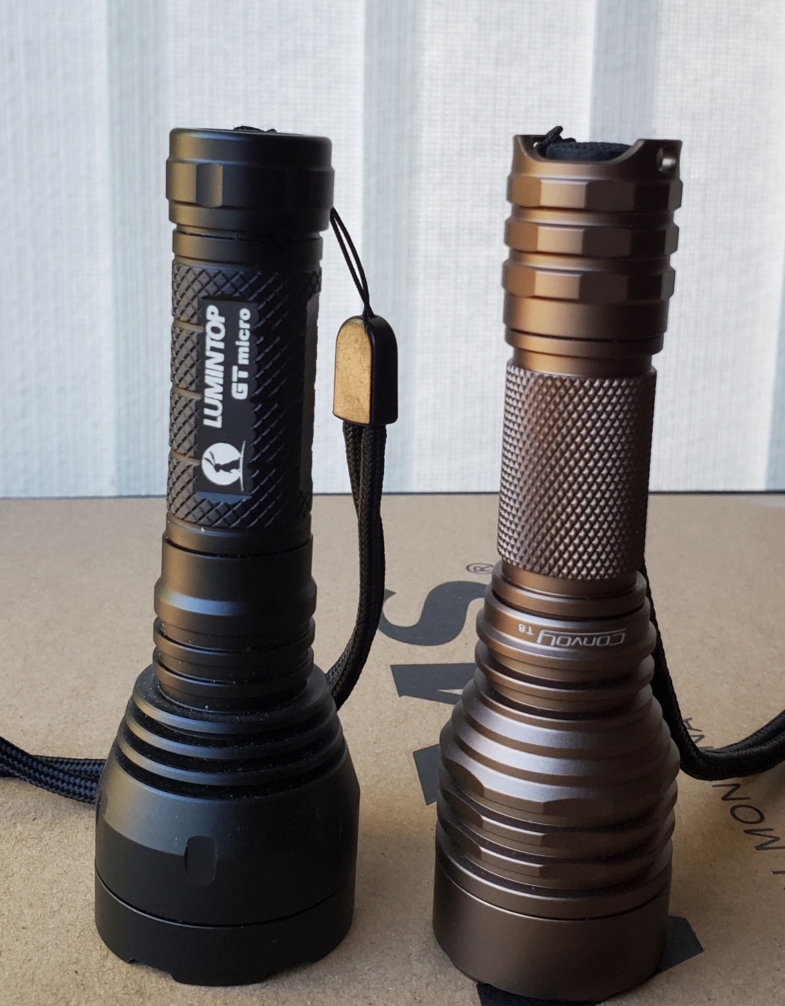

All 3 of these Lumintops use the throwy Osram LED CSLNM1. All 3 are old release and in fact are no longer made. GTA is a dual fuel 14500 + AA design, with tail switch. The GT Micro twins, one brass one copper, are 14500 only with side switch and interestingly enough, Tom E’s NarsilM firmare adapted by @Texas_Ace (who makes my lumen tube?). Narsil is the forerunner or inspiration for Anduril. And of course, Narsil is also the sword later reforged into Andúril in Lord of the Rings. LOL - per AI and confirmed by my son, a LOTR expert.
AFAIK my GT Micro’s are not the original version with XPL HI, but the latter release with Osram. They are rare as hen’s teeth and I was so happy not just to find them, but find them with significant discount. Why my jubilance?
  1. Hands down the most beautiful lights in my small collection.
  2. Absolutely outrageous thrower @ 830m. Yep for a smallish 14500 light this sure is outrageous. This ought to be about the furthest throw ever for a 14500 light.
  3. On sale at almost half off at illumn.com

Very quickly after starting this mini-thrower comparison, I realized there is no clear winner. Each light excels in certain areas, and all 7 have can’t-miss, fun, throwy beams. Having said that, these are my top 3, YMMV:
1. Convoy T8 SFT-25R 5000k: A “unicorn” thrower because of its warm color rendition and beautiful non-greenish tint. Add fantastic buck/boost driver without PWM, dual fuel, rock bottom Convoy pricing, and this becomes a must-buy. 6500k has subjective “clarity” to me, 5000k is unique, both extremely highly recommended. A little large for 14500 light.
2. Lumintop GT Micro Copper/Brass Osram CSLNM1: Stupendous 800m plus thrower (longest ever recorded for a 14500 light?). Largish reflector + small LED result in very small hotspot. But… this also means the most fun and laser-like beam profile of this group. Has greenish corona that does not bother me in real life use for throwers (vs flooders) but YMMV. A rare, beautiful, premium quality light on big discount. Check out the copper patina. Great self gift for upcoming Holiday season :-).
3. Wurkkos TS15 SFT-25R 6000k: Size is everything in this class, and here TS15 is the clear winner. Tiny enough to fit in a shirt pocket, yet with on-board USB-C charging and dual fuel capable. This tiny of a size and still throws 420m? A marvel of modern LED and engineering.
