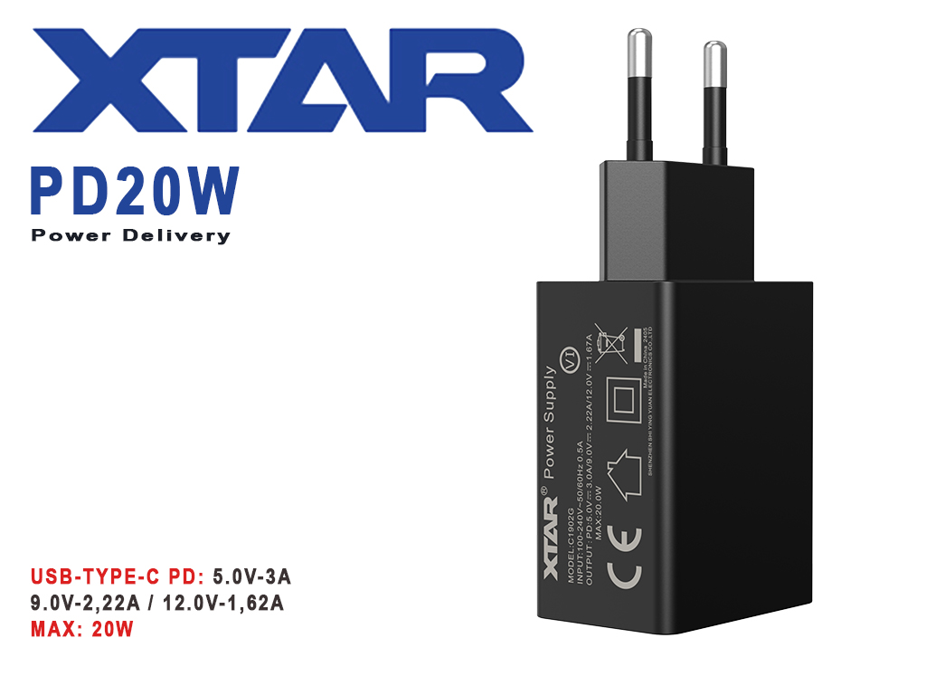

If you get the Xtar SC2, you need a USB charger with 12V PD (PowerDelivery) - otherwise it will charge with 1x 2A and 2x 1A.
Unfortunately, the 12V option was made “volontary” in later versions for USB charger standards, so some chargers support it, some don’t.
I bought the XTAR PD20W, which supports 12V:
