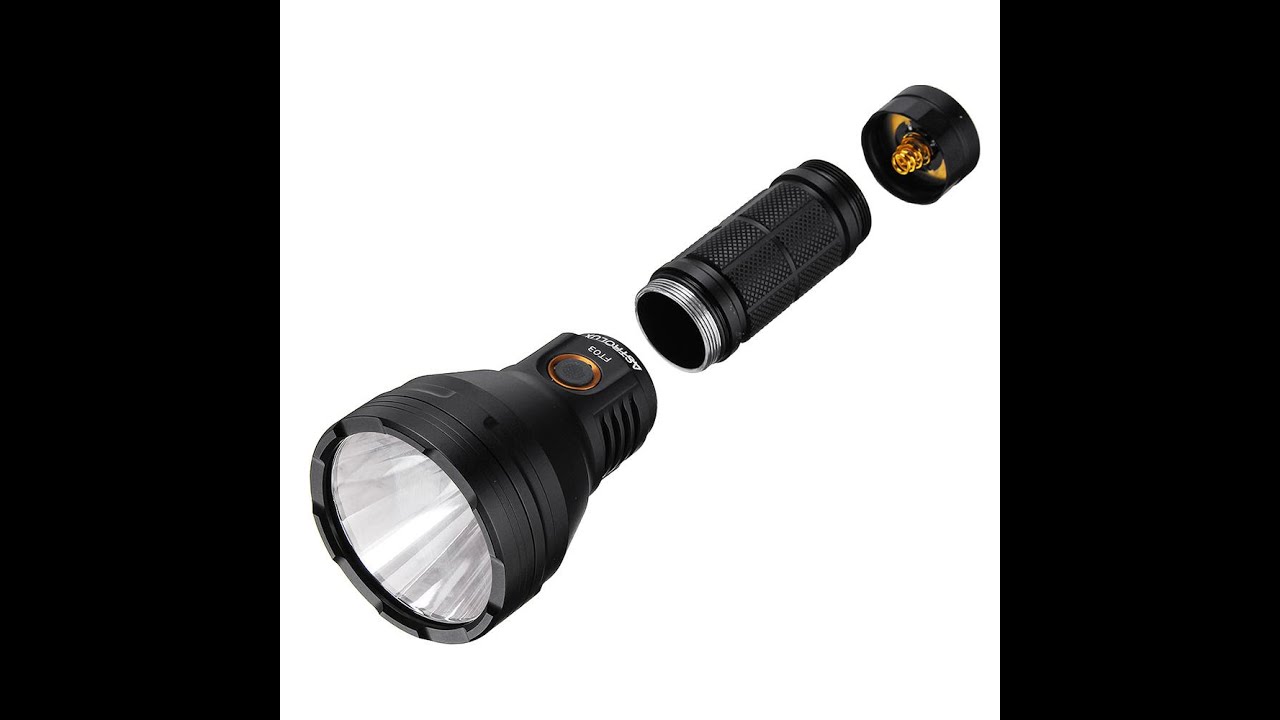

Best Method To Replace Your Astrolux FT03 Thermal Paste!
It can be said that at the present time with a price of only $ 30 Astrolux FT03 is the most affordable flashlight.
We can increase the performance of Astrolux FT03 significantly when replace the new thermal glue.
If you don’t have a good iron, do it my way. Removing the led is not a good option It takes a lot of time. Good luck my friends.
