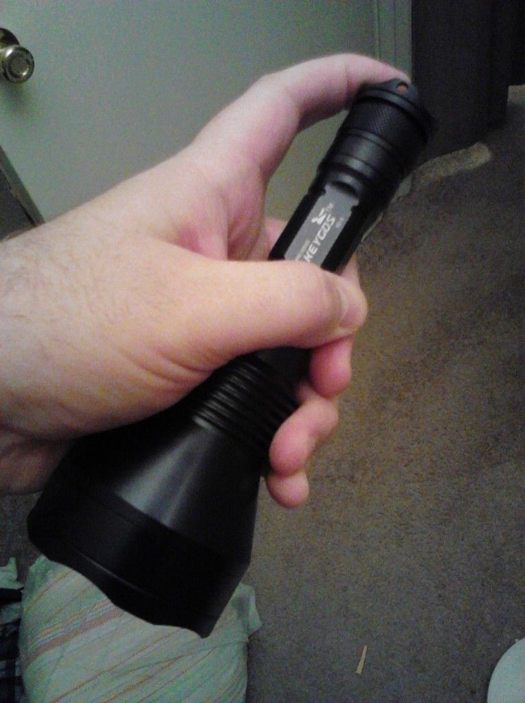

The STL-V2 is a wow light that still has my co-workers assuming it is the brightest I own. Nothing impresses like throw, especially when that throw is made by running a Keygos KE-5 single-cell 18650 body in for lighter carry!
hey rusty, what do you mean by…. Nothing impresses like throw, especially when that throw is made by running a Keygos KE-5 single-cell 18650 body in for lighter carry!
are you saying it unscrews to a 1 cell and it will perform like a ke5?
i own a ke5 already, and dont think it throws that well. i mean it throws for a single cell, but if the stl v2 throws like that for a 2 cell, its not very impressive then.
No, no, no. I’m saying an STL-V2 can use the body of a standard C8 and the one I use is the body of my Keygos KE5 like so…
