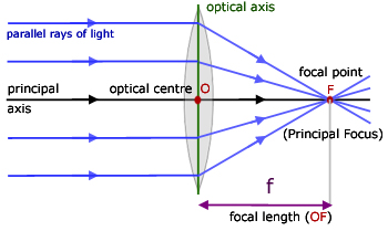

i hear and see a lot of aspheric lens flashlights but never have i really seen much in the way of biconvex lenses. As i understand a aspheric lens will collimate light, but not perfectly, the light will always diverge and hence loose its intensity as it gets further away from its source.
So this brings me to biconvex lenses. as i understand they will perfectly collminate light to infinity, so this way you will end up with a column of light that wont loose its intensity as it gets further away from its source. Wouldn’t this be what we would be striving to achieve in a super throwing flashlight?? So why dont we use biconvex lens systems instead of aspheric lenses?
correct me if i am wrong but i must be missing something here….i have included some pics to better understand what im trying to say, a picture says a thousand words!!
