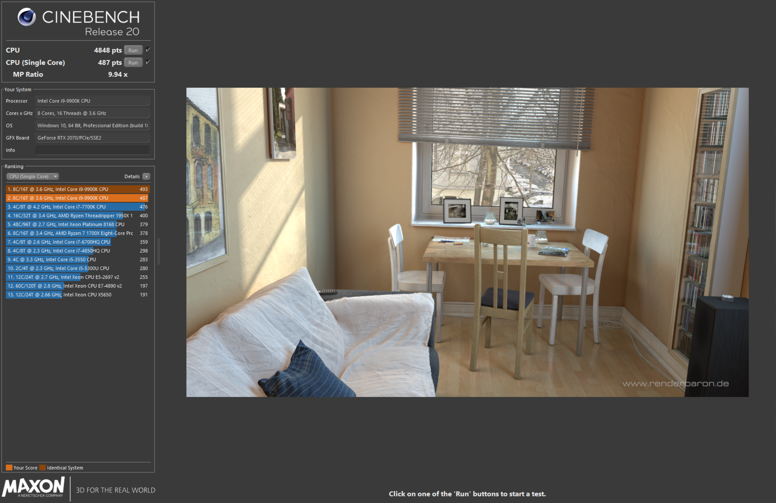

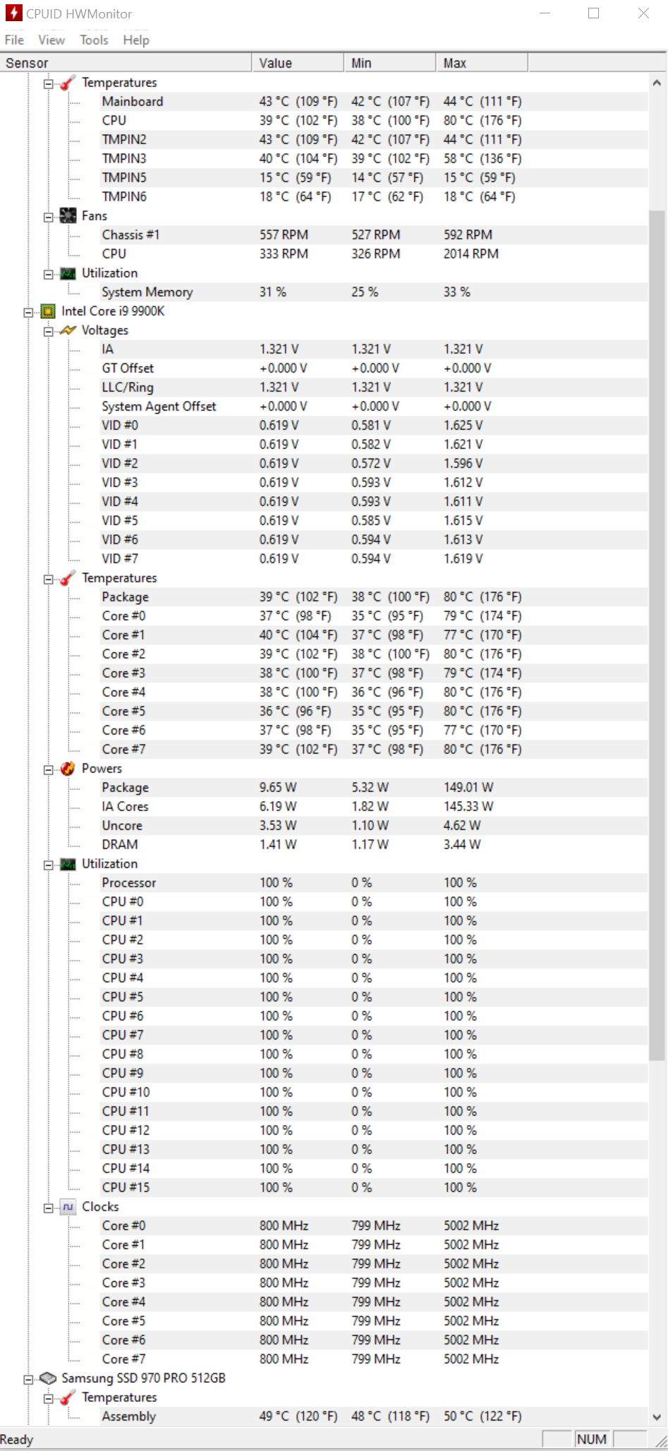

It’s sick to gain 12% single core speed over multi core single uses 40W while all 8 use 137W
It seems that the OS just runs the single core operation not on a single hardware core, it keeps jumping from one to another so on all cores the clock and voltage keeps high
The good thing is on the ASUS suite I can put the Eco more for example to 10W

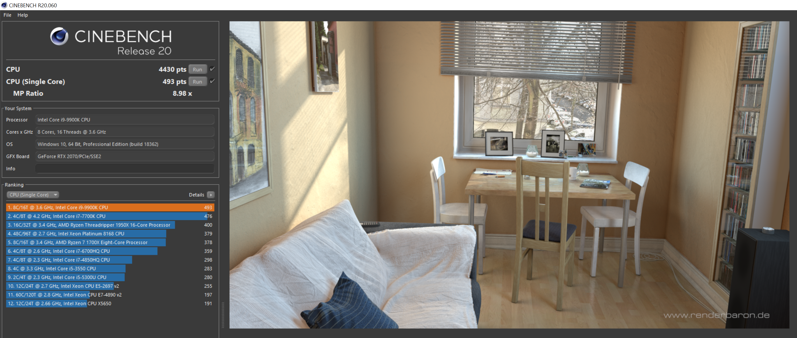

I changed some settings in Bios
first set the LLC to a less aggressive value
then set SVID to best case scenario
The overall performance in multi core got 10% higher, as now the CPU has under load 0.15V less (1.27 vs 1.42),
but all cores get a higher clock speed of about 400MHz at same power consumption
The single Core speed stays about the same but at 5-6W less power consumption, but does not reach 5GHz anymore only 4.9GHz
before
after

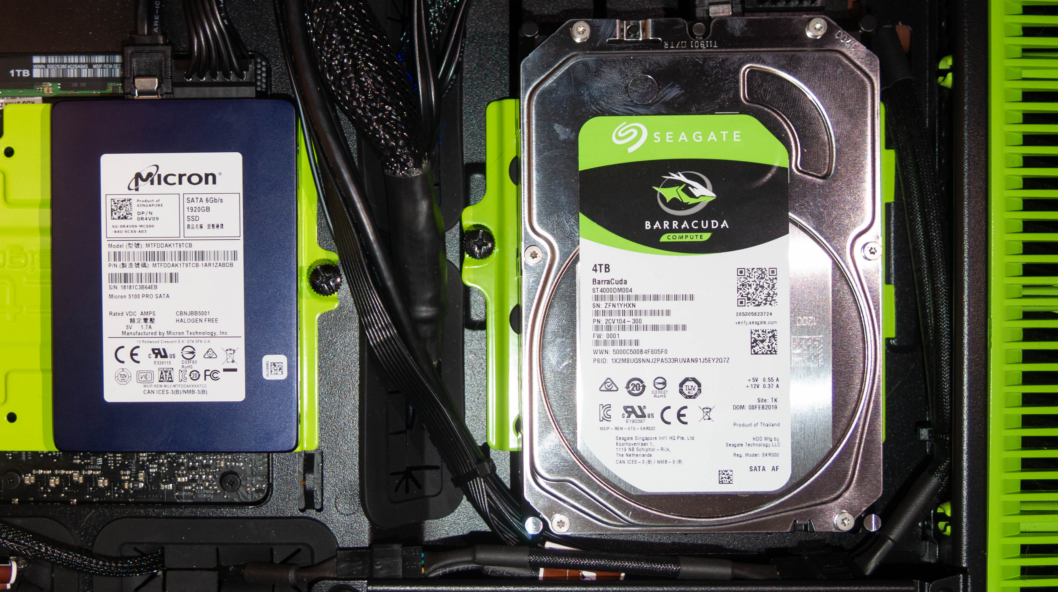

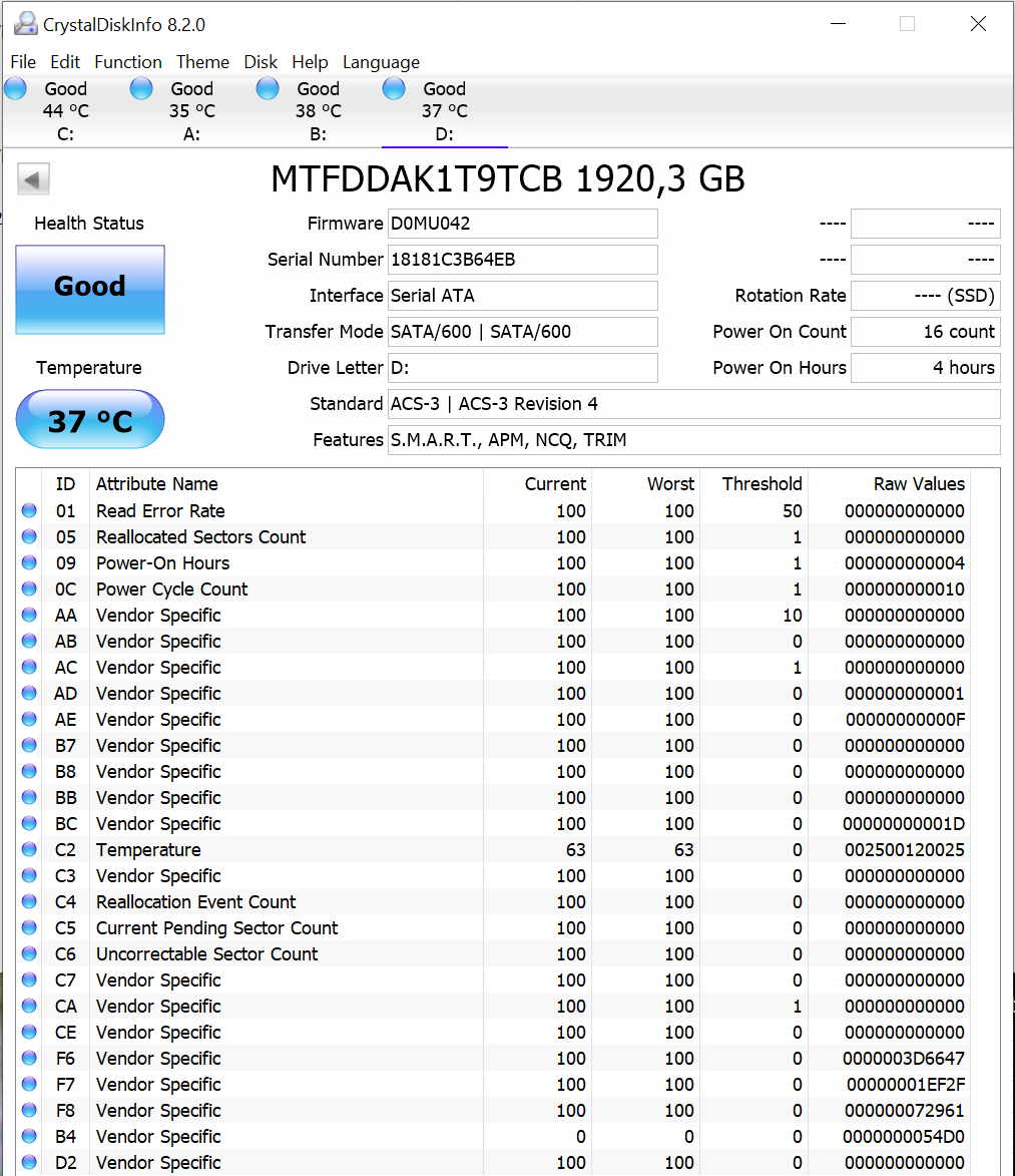

wanted basically more SSD space so the HDD is purely backup
Grabbed on eBay basically an unused server grade SSD (per TB cheaper than used Samsung 860 Evo sell)
Micron 5100 Pro with 1.92TB
