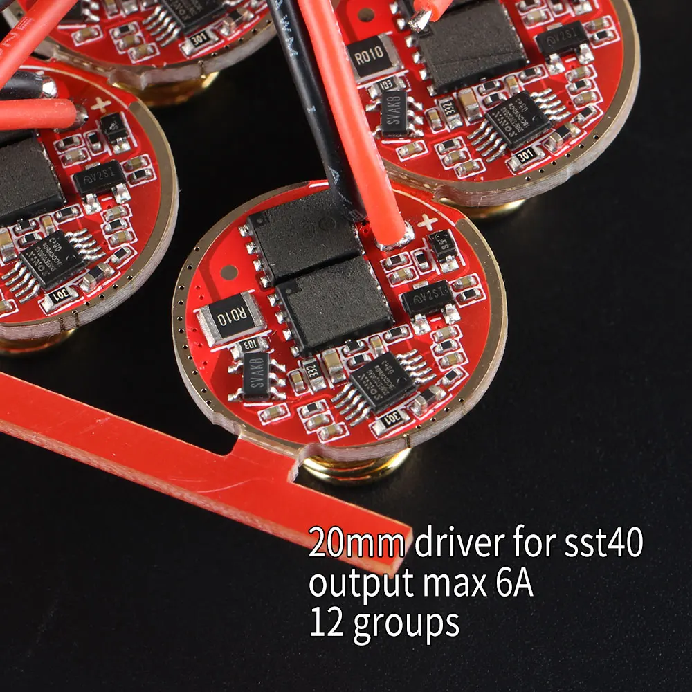

If you’d be ok with 6A(FYI 12group = Biscotti):
20mm Driver ,12groups , max current output 6000mA, Temperature protection management inside
That looks good. Thanks
My german is not too hot lol. Is that a FET driver? 6A looks more fun than my previous 3A driver! Its says for SST40. Also good for XM-l Hi?
Yeah it’s a Linear FET driver.
The XPL-HI can handle 6A according to the tests I’ve read.
