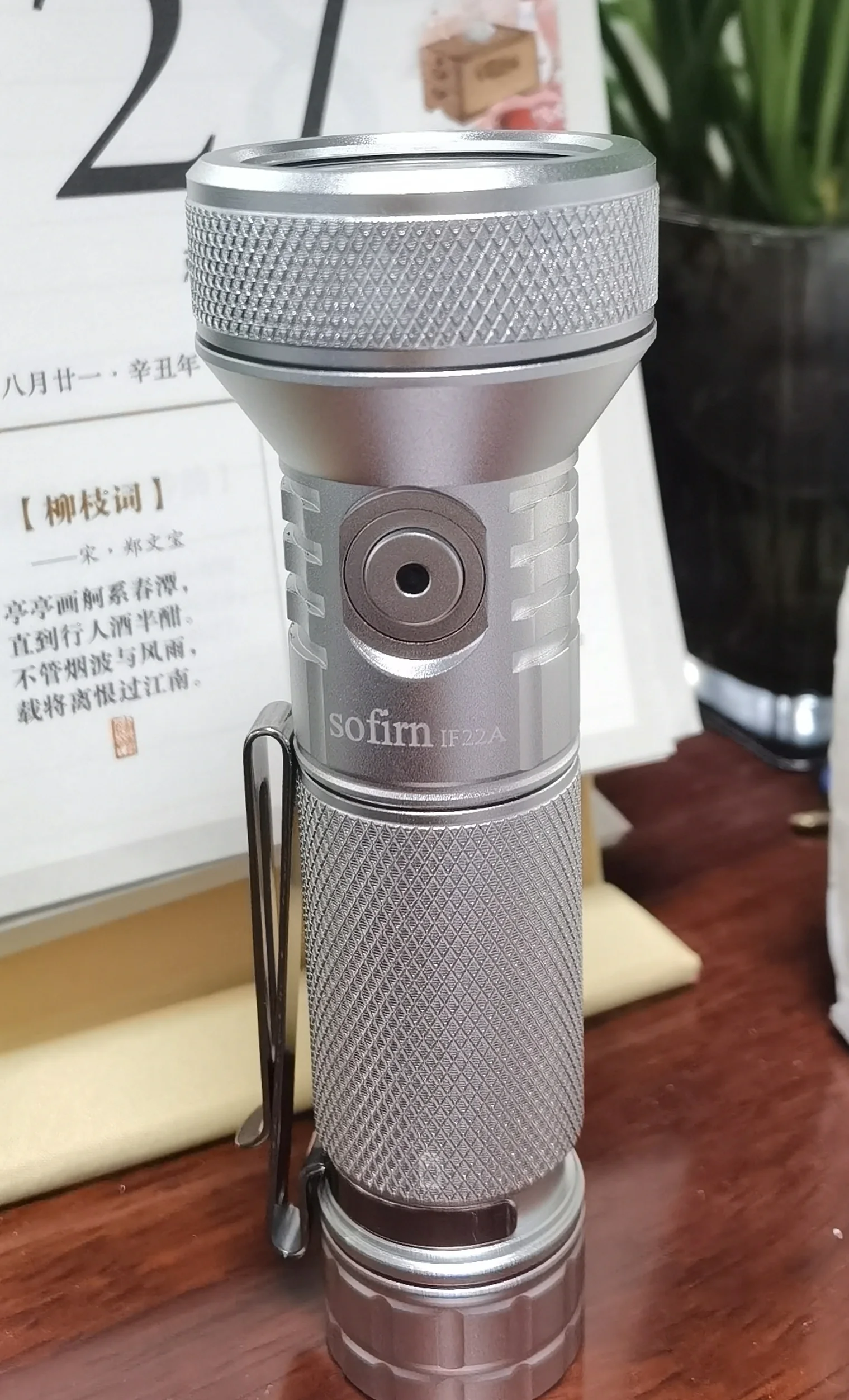

would love to try new sliver color if IF22A? go link to:https://www.aliexpress.com/item/1005003349281393.html?spm=5261.ProductManageOnline.0.0.1c394edfiG4TCz

I think Sofirn looks great in silver and then I wouldn’t have to use drain cleaner!

Jackie, is this silver version bare aluminum, or is it clear anodized, or coated in any way?

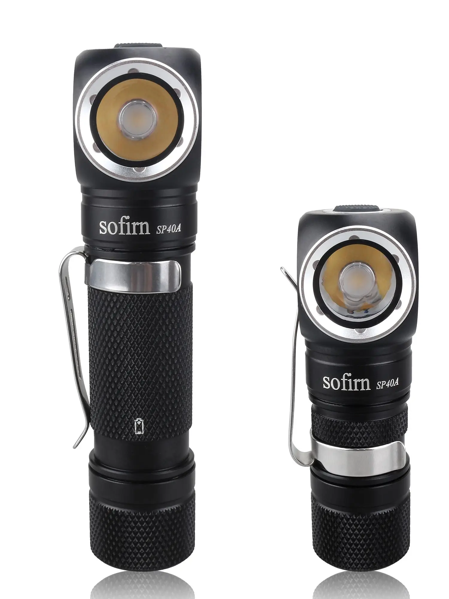

New release ,sofirn classic SP40, with TIR options now and high CRI LH351D LED, named SP40A, link :https://www.aliexpress.com/item/1005003349962516.html?spm=5261.ProductManageOnline.0.0.21ff4edfI4J6u8
