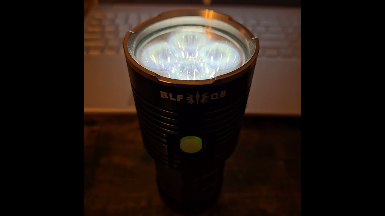

Hey gang! We have some bad weather heading our way. So I’m getting all the flashlights charged up (as I’m sure many of you all do too :smile:). And I remembered I’ve been having an issue with my original BLF Q8 from loooong ago. Here’s the video:
It will not go to turbo, and just flickers. Sometimes turns itself off. I checked the batteries. I can take the same batteries, put them in my spare Q8, and it works just fine. It seems to be an issue with this particular light. One thing I did notice is the screws, on the one I’m having issues with, are raised (pan head). Whereas the one that works great has flush mounting screws (countersunk).
I dount theres any way to get parts or a replacement driver for it. So is there any way to turn this thing into a monster light? Like 4x XHP70.2 :sunglasses:
