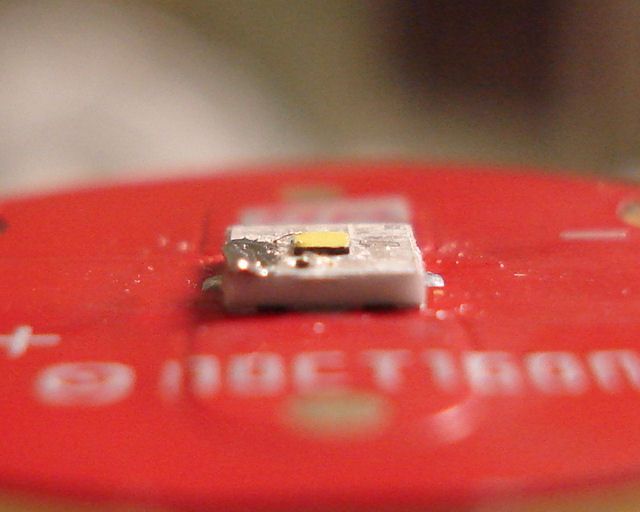

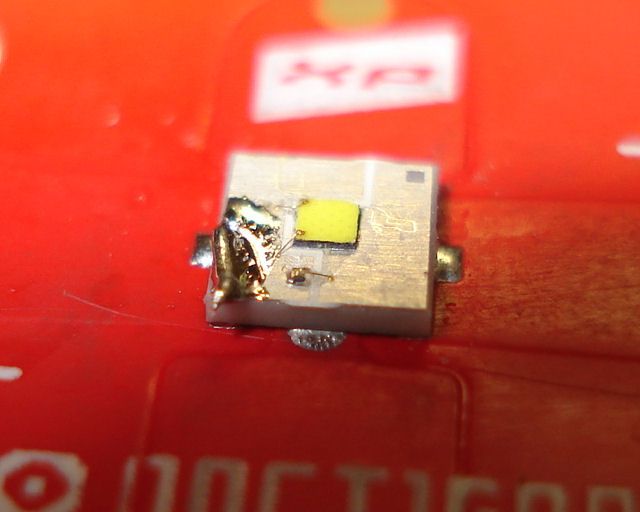

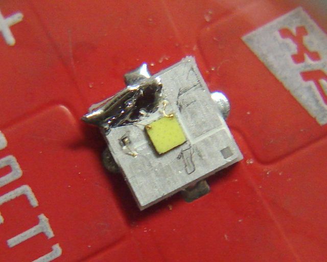

My first XPE2 Torch dedome didn’t go well so I figgered I got nothing to lose trying to solder the broken bond wire. I filed down the tip of my iron, put some solder on it and carefully touched it as close as I dared to the wire. It didn’t look like any solder got the wire so I snatched it up and threw it in my dead LED pile.
Today, I grabbed it to test the effects of xylene on the phosphor and thought just for jollies, I’d test the LED. Let’s just say I started handling it more carefully afterwards.
You can see how I luckily only bent the good wire while mishandling it:
Looks like a little polished turd sittin’ there.
I really don’t know how good the solder joint is so I won’t run this one hard.

I did the same thing with a dedomed XP-L a while ago, though mine was even uglier :wink: . It worked up to about 1.3amps before it popped again.
