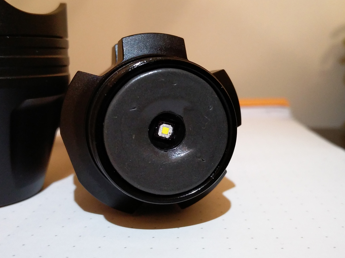

This is my first proper zoomy and my first attempt to dedome a led. And it all worked out beautifully :slight_smile:
XP-G2 S4 2B dedomed with arctic silver, BLF A6 A17DD-L from BG, 18AWG wires everywhere and I’m reading 4,5A in the tail.
Since I didn’t have heat resistant paint I used black marker and sugru around the led. It should be heat resistant to 180°C (356°F). It’s not pitch black and not 100% matte finish, but I wanted to try it out anyway. Black permanent marker leaves way more reflective surface. The plastic ring is underneath, so it should be 100% reversible, if need be.
And some pictures of my badass amp reading setup featuring X6 in the last picture
