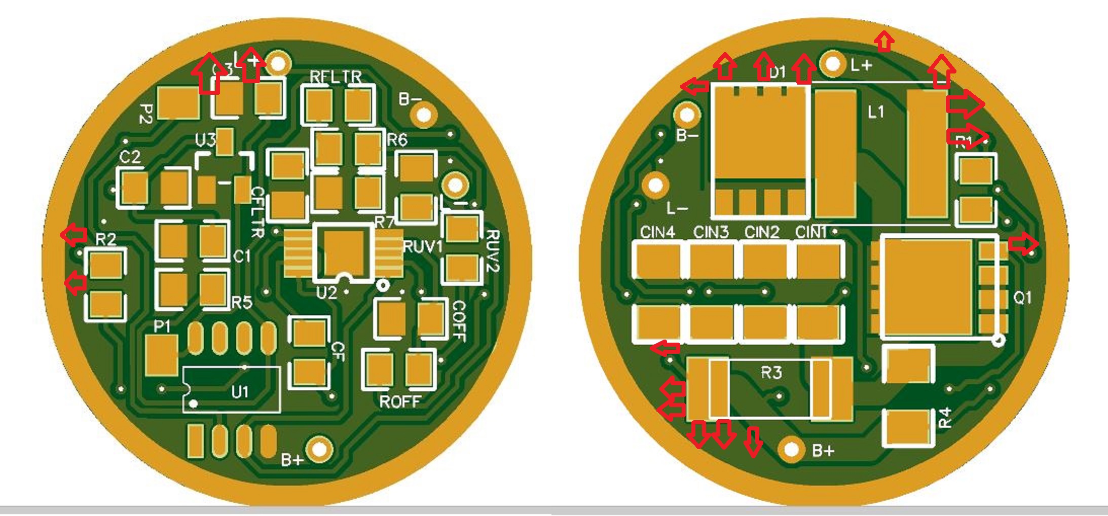

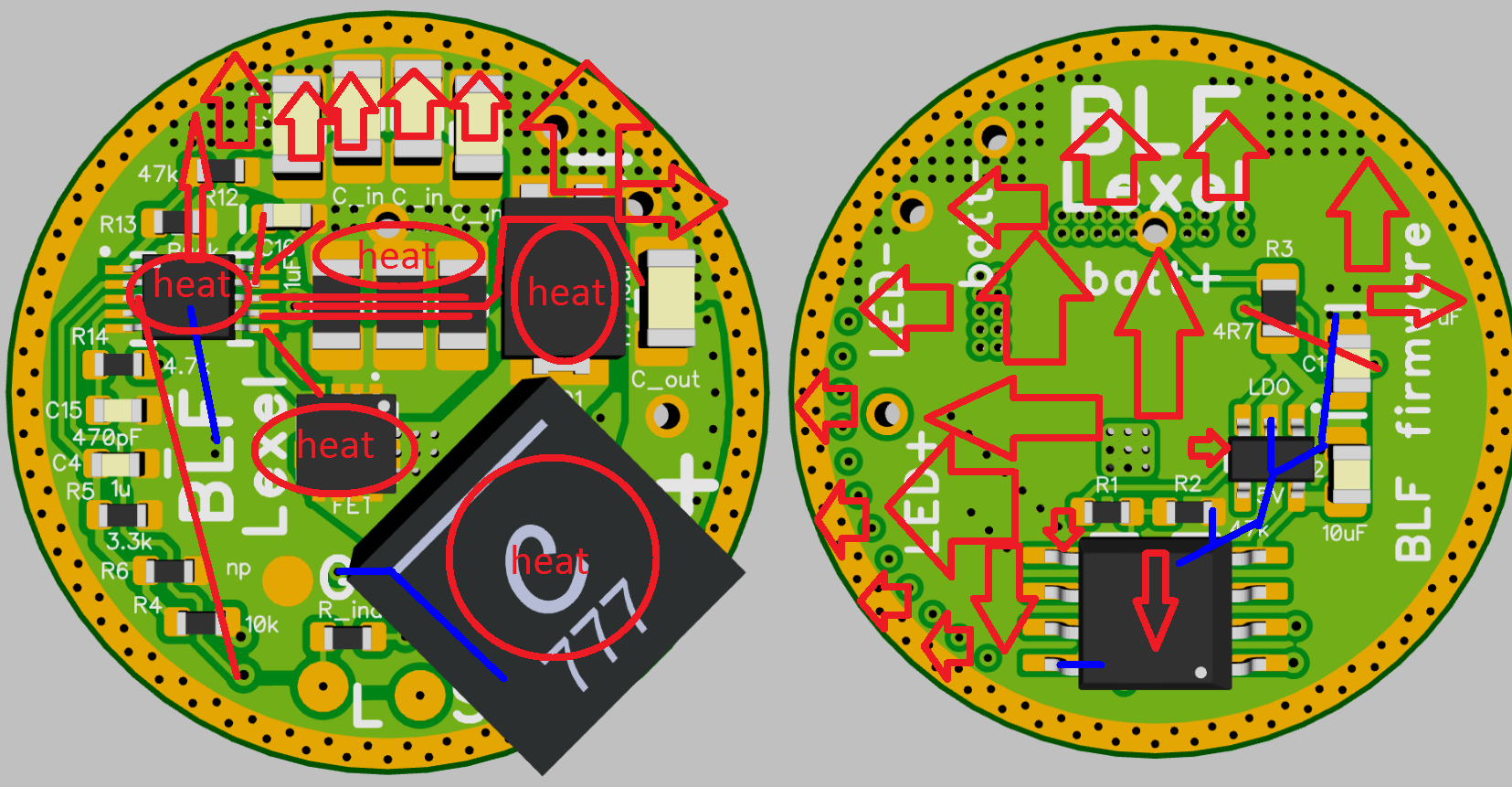

I just made a quick design on 26mm with your via power connection
as you can see there are way more efficient variants to trace such a driver, not your spagetti tracing
tried here to explan the wiring and heatflow
of course there is more potential to get the heat paths better
I looked at your design and direct copper heat transfer is very small
