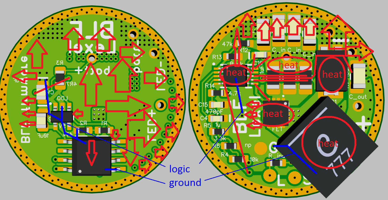

if you look on my design the logic ground splits below the LM3409 from the power ground
and I wrote earlier if you don not do that the LDO might freak out
also putting the battery- and L- apart from the input/output cap is a really bad idea
switching node gets heated by the MOSFET, inductor and diode best is here also put viases into a ground polane on the other side
also as the inductors switching node is already heated by the MOSFET its crucial you spread the heat on L+ making that copper area bigger and also get viases to the other side ground plane
so try to get the back side as less populated as possible
