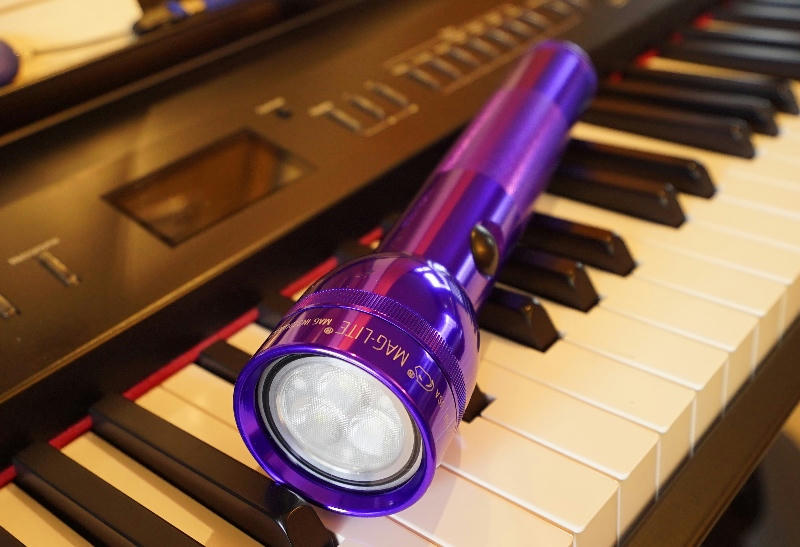

Love my purple fire-starter (link) custom Adventure Sports Maglite (hand built by Mat). UI programming DrJones Guppy2drv. 5,000 lumens on high. Uses two 26650's. Gets scorching hot if PID is not turned on.

Hi Terry, Do you have any extra purple or green Mag hosts? I would MOD or have Modded those 2 colors for collection. BUT if you decide to sell the purple one give a a hollar. Thanks.
