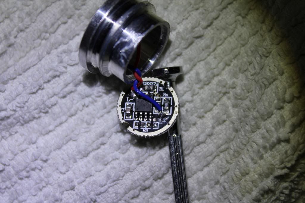

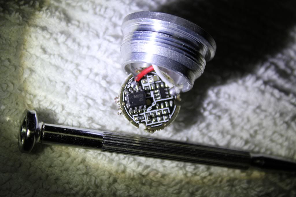

First 2 pics are of the same board (Generic C8 no name light):

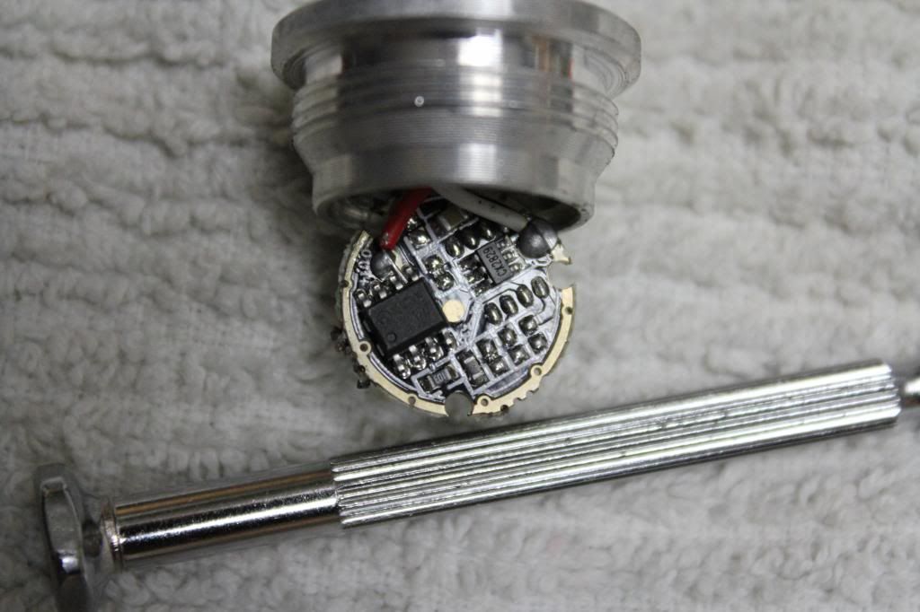

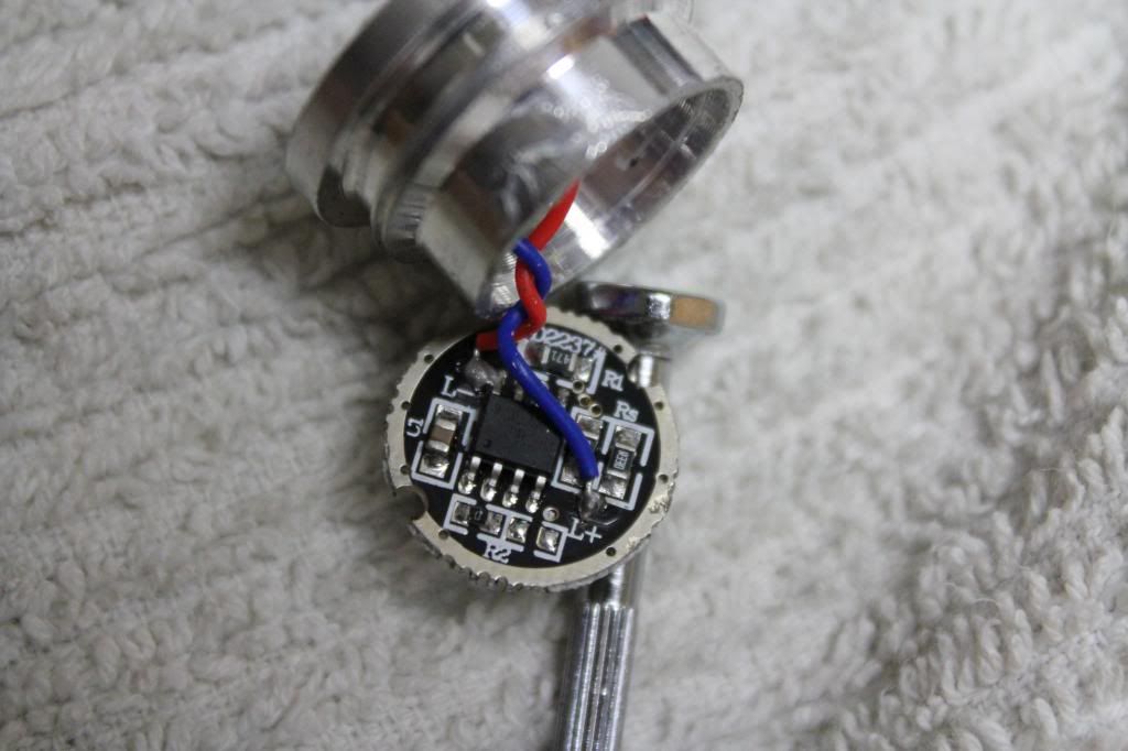

These next 2 pics are of the Ultrafire branded light:
Will those pics help identify if they will handle an extension tube?
Thanks a lot!
Ultrafire just puts a microcontroller there and some resistors to limit the current, now that's cheap.

Neither of those drivers will handle 2x18650. They MAY handle 2xCR123A primary cells.
