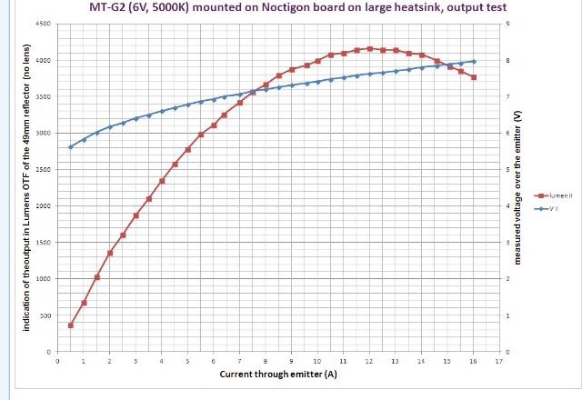

What do you think, how much current will the 6V mt-g2 be able to take in this rather small host?

You can stack 4 to 8 more 7135’s on your Qlite but 16 total 7135’s is around 6 amps. That would definitely be a hand warmer. The MT-G2 will take a lot more but the payback diminishes very quickly up there.
Djozz tortures a MT-G2

Djozz graph
