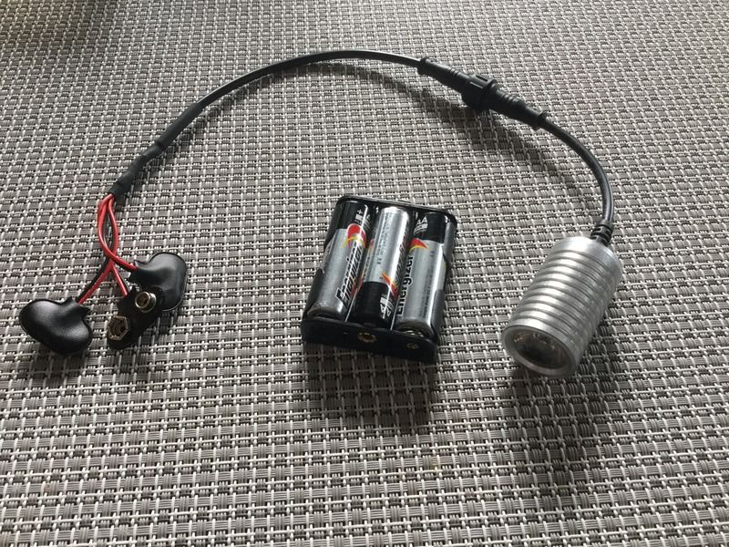

I just completed a light and I need help estimating possible run times please with it remaining on.
It uses a Cree T6 emitter with a 3-5volt input 700ma constant current driver.
The battery packs are wired up so that each pack can run off 3,6, or 9 batteries but voltage remains uniform. I appreciate your help to know what I might expect for runtimes in the following scenarios:
9 standard alkaline AA batteries running at 4.5 volts
9 Eneloop Ni-Mh (up to 2000mah) AA batteries running at 3.6 volts
9 Energizer lithium AA batteries running at 4.5 volts
I’m in the process of making a 2nd light as well. The difference will be that it will use a 1400ma driver instead. How would run times for this setup differ. Half as long?
Thanks for your help.
