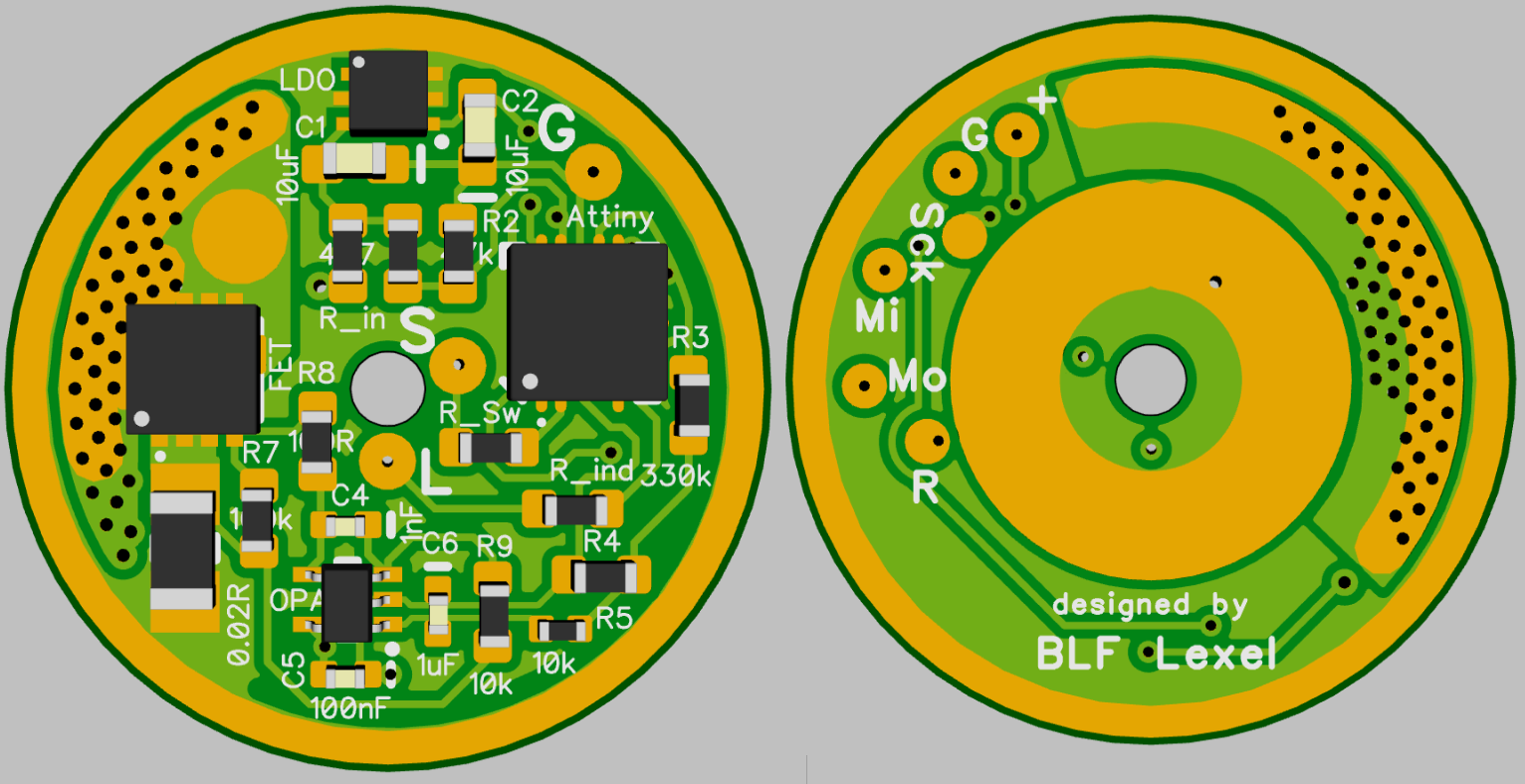

I put something together
testing out the right values for the CC part will need some testing
the 2 blank copper areas are to solder a piece of copper wire likely hammered flat to spread heat better

So, this driver needs a heat spreader? Wow!
Thanks Lexel! Are you planning to build/sell these? If so, when do you think it will be done testing and ready to buy?

You should sell these to Hank so he can make D1S with White Flat.
Lexel
(Lexel)
348
Hank is right now not interested in white flat D1S, I tried to offer him driver but he said
it may happen later we will see

when will this be ready for order? also will it be a 5A buck driver?

Any news on a CC driver I can fit in flat white D1s?

352
Any updates on your driver, Lexel?
I put one together, albeit much more rudimentary than yours. 5x CN5710 (dual channel: 1+4) for 5 amps linear. Working good so far. Without any reflector height tuning, got 958 lumens & 273k lux with a Flat White 1mm² (vs 1540 lm & 127k lux stock driver with XP-L HI)

how much for this driver? and do you ship to Thailand?

I can sell a few prototypes
Price as usual is 12€
Anduril or NarsilM as firmware
shipping is 1.4$ from here untracked
5$ tracked with 25€ loss insurance
v2.0 I made some minor improvements from the original prototype
any recommondation what to change?
