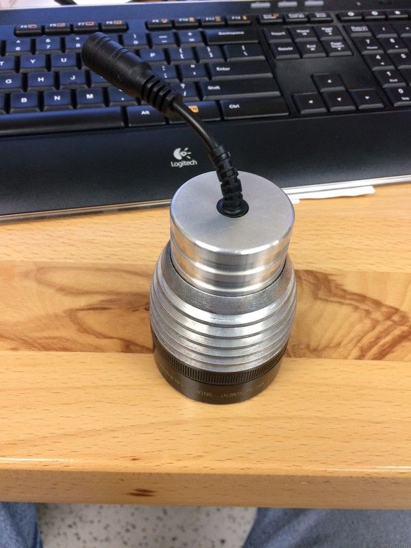

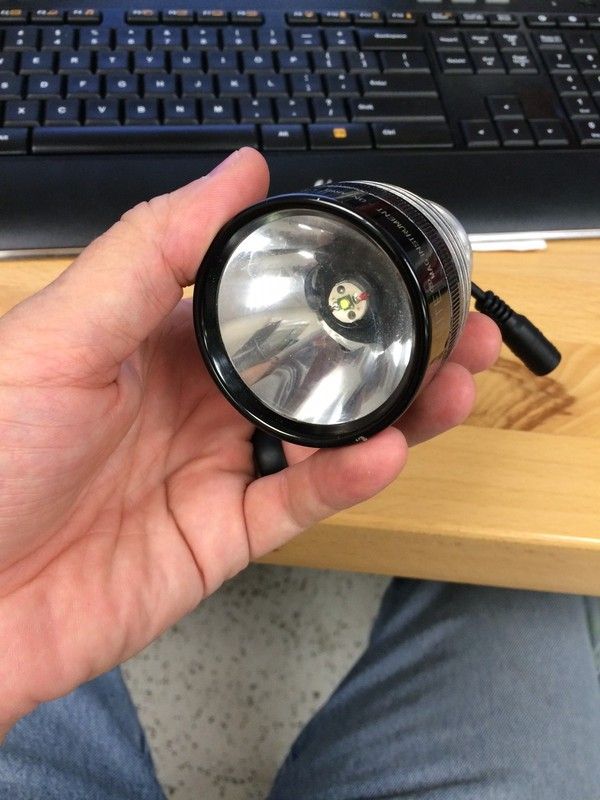

I’ve got a maglite conversion that works incredibly well with the reflector but it’s big and heavy. It measures 325 lumens out the front. Malkoff 3-6 D cell drop in.

I was thinking drivers as follows: 350ma for the on all the time light and 700ma –1000ma for the on/off light. I don’t even need to use 6 volt packs but those are what were built for my Mag head. The Mag setup is ready to go, but I’m wanting to make something smaller, lighter, and with more options.
