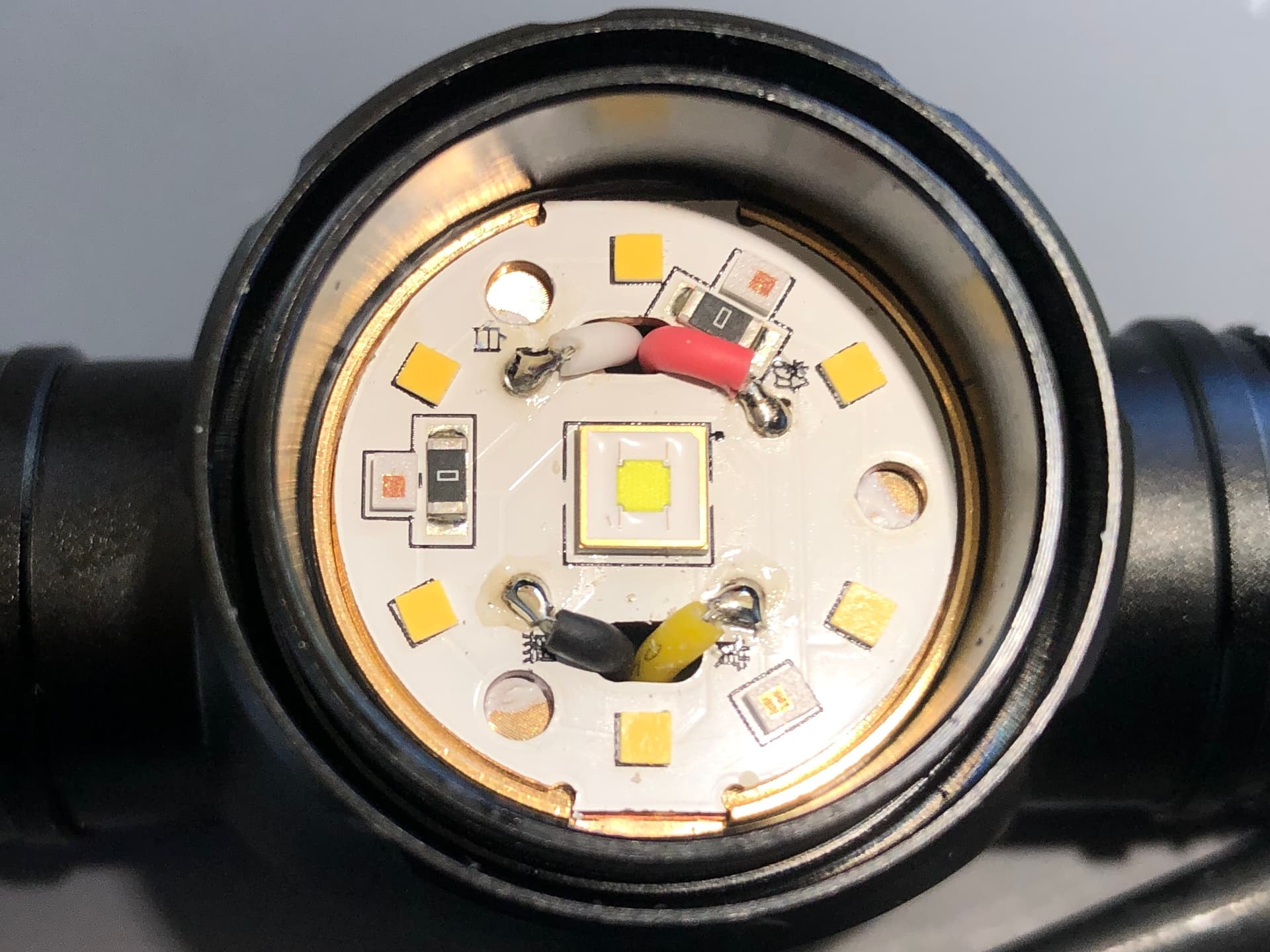

I would be tempted to replace the Low CRI Cool White SFT-40 with a High CRI model (without tryiing to match the CCT of the Flood LEDs:
Oh, and how did you open it up?
And what are those black items next to the two of red LEDs?
I’ve never done it, but what happens when you put this thing on a hot plate to just change the centre SFT40 but want to leave other LEDs alone?
External Circlip Pliers:
thats fine, if you dont touch the other components, they stay where they are
Here is a modding sequence album for the TS10SG, it also has extra components that I did not touch when I replaced the center LED
