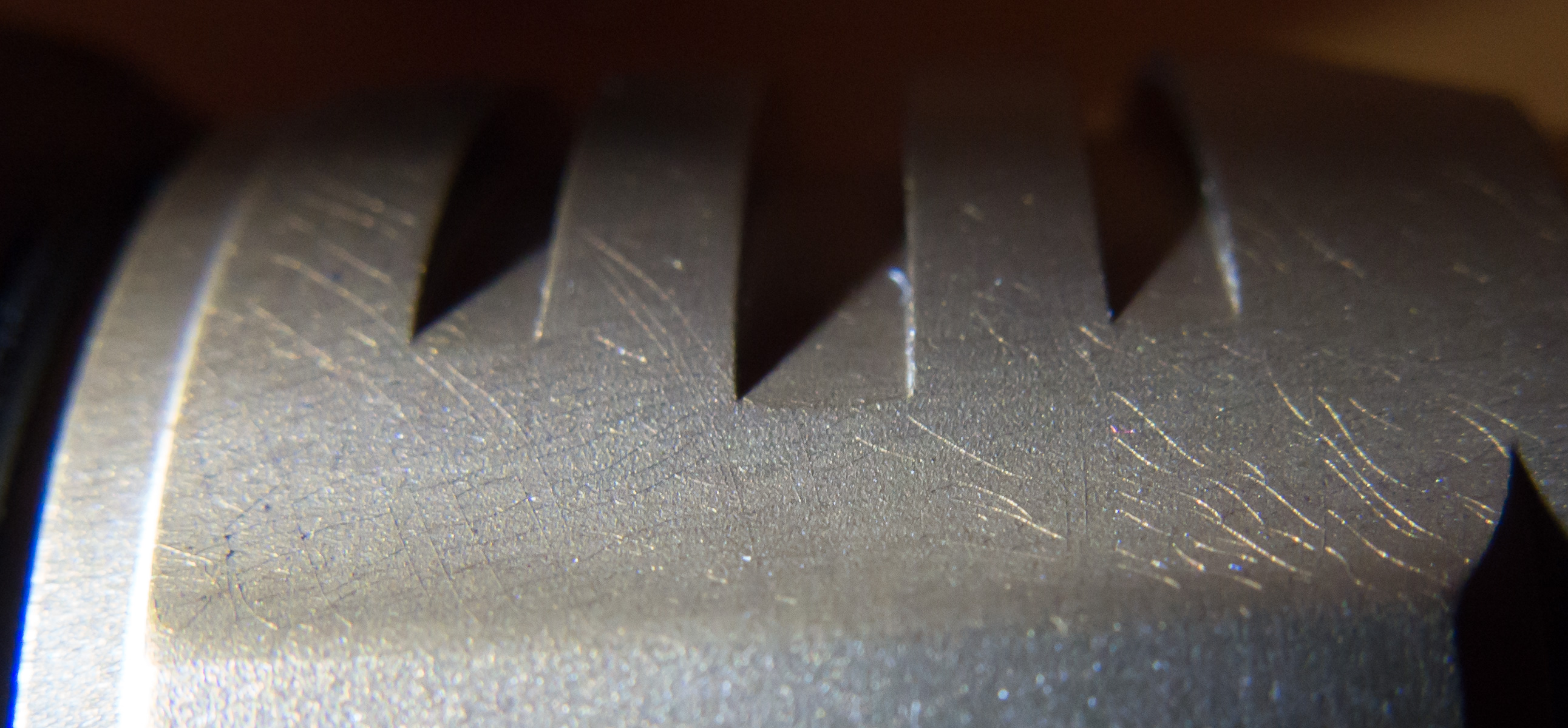

The HIII anodisation is a lot more robust to heat, but its so thick you hear it cracking while heating up, because the aluminum exopands more.
There are a lot small cracks visible when look closely.
