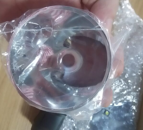

Coming soon: TrustFire X6 modded with XHP35
Asked TF not to assemble the light,but just send me the parts. (Saves me some time opening the pill). Will order XHP35 from cutter next Monday. Hope it could arrive fast.
I really like TF-X6, big head with a slim body. 80mm head (72.5mm reflector) with a XHP35 under a zener modded BLF DD, can we get 1k meters throw? Can't get any info about how much current can we pull the emitter?
