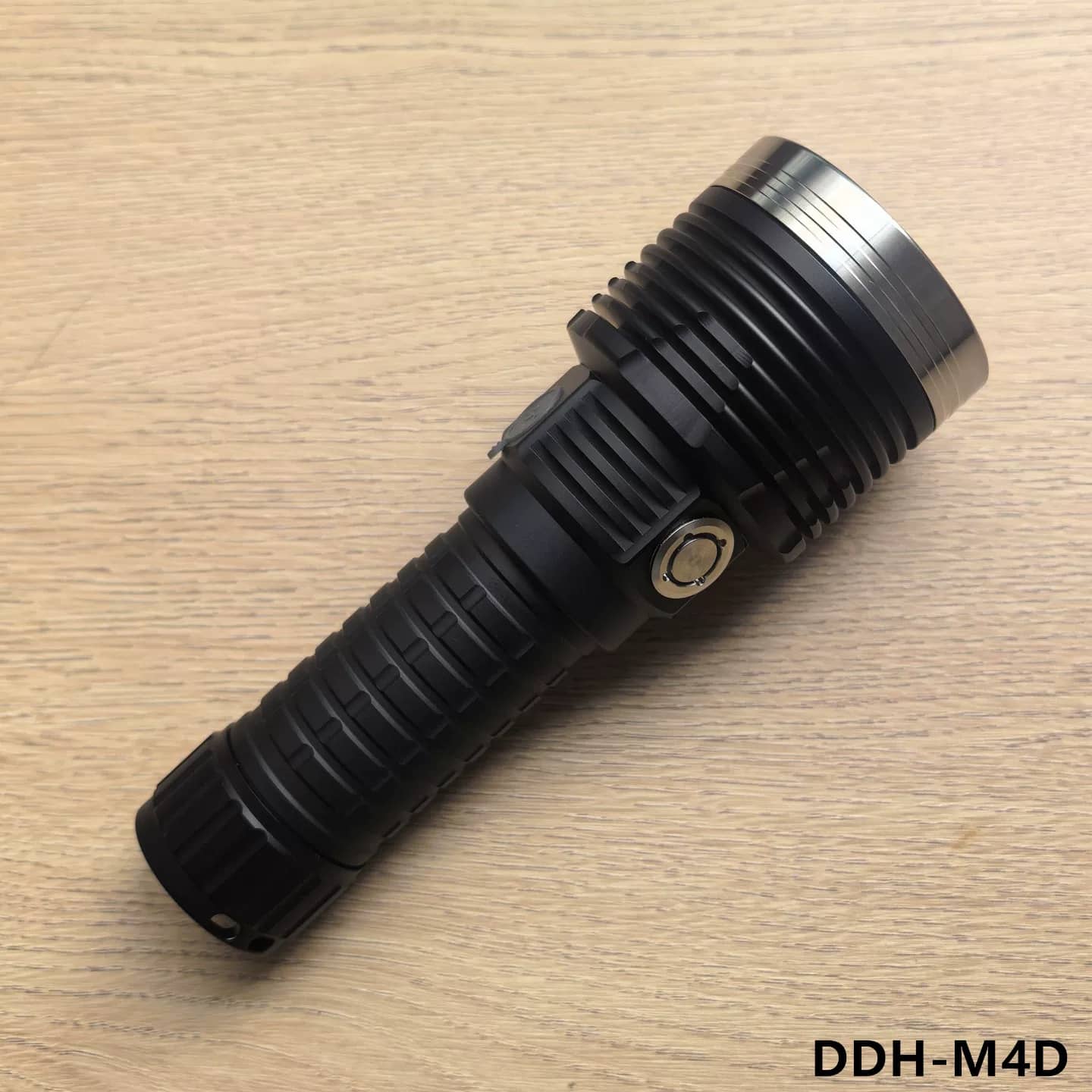

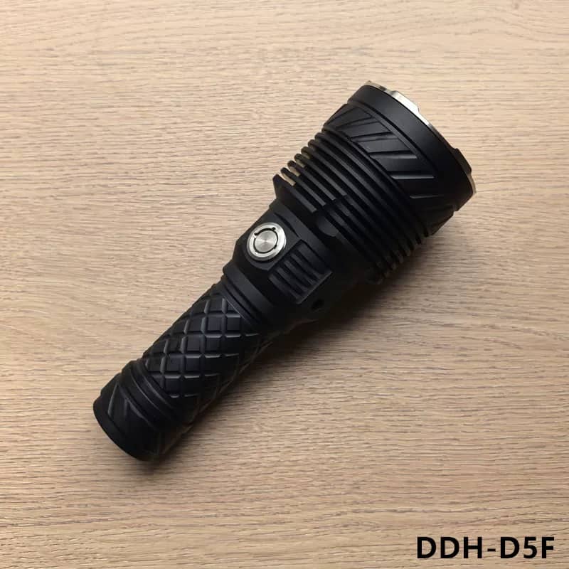

To stir things up, have a look at DDH(Dongdonghi) M4D and D5F.
Similar in head diameter, it can take a 26650 or 21700(with adapter sleeve).
Or even better, 26105 11Ah battery with the newly available tube.
Pair with XBY32 you gain 5A usbc onboard charging, actual useable ramping and an overall better UI(andruil mock).
And enough to power the F150R (18A + FET, configurable to 33A Buck Turbo) for pencil beans.
(Beans borrowed from members, D5f, F150R 3000k)

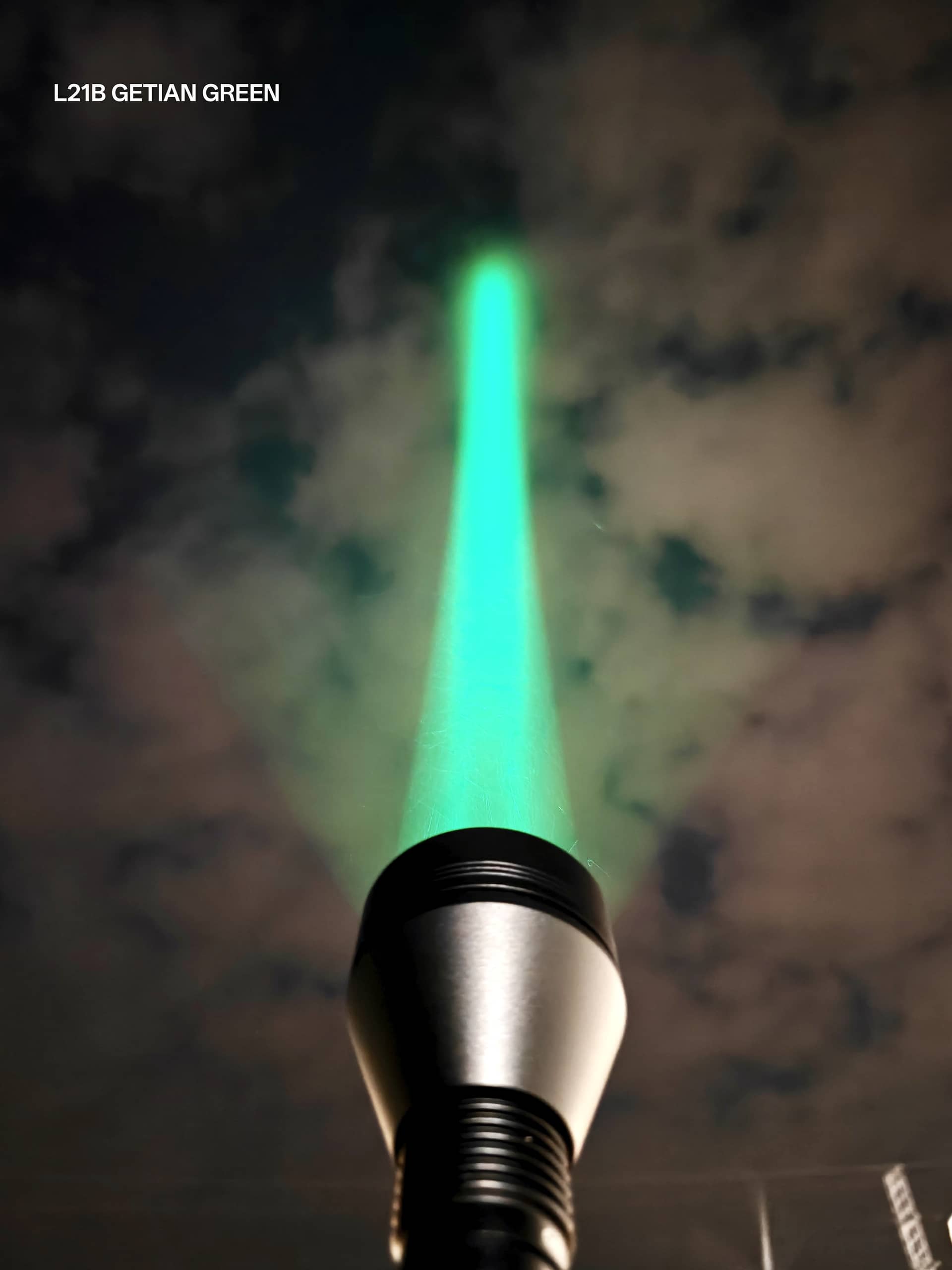

Why the green ? Other than my light saber is green and not red is there some advantages ?
I also recommend the SFT-25R..
Green light wil almost always look more intense/crazy vs the same one in a white colour. Atleast in my opinion.
