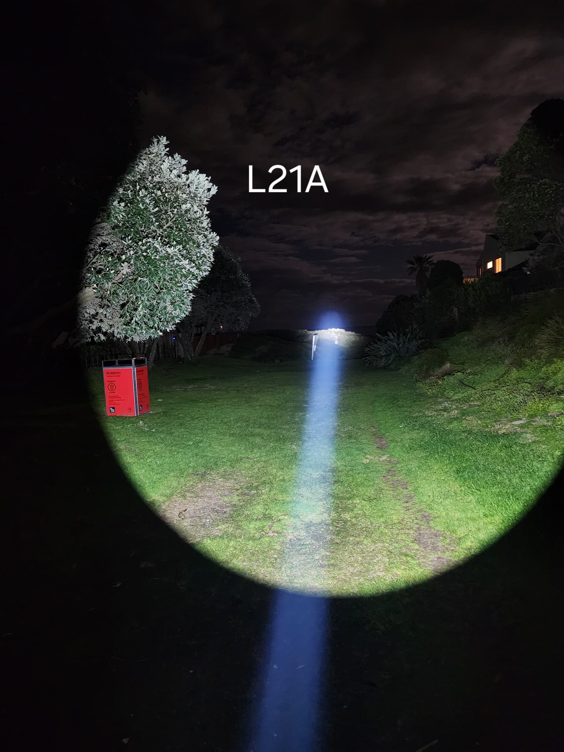

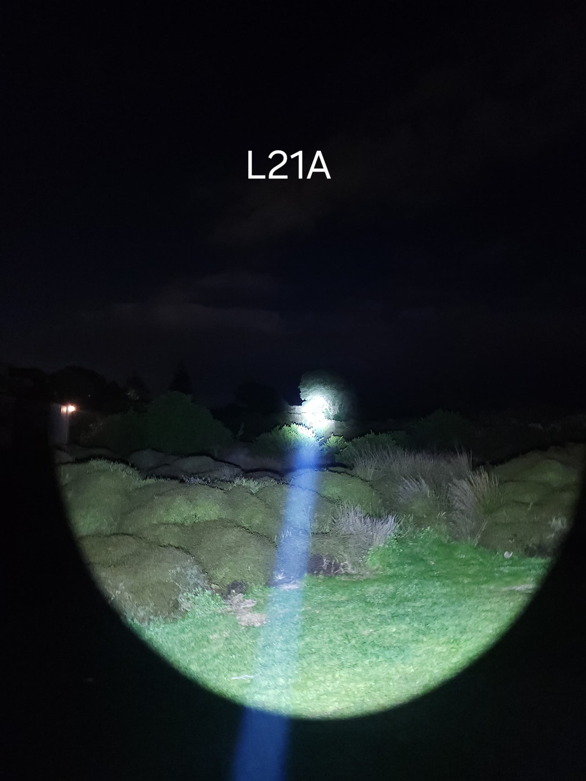

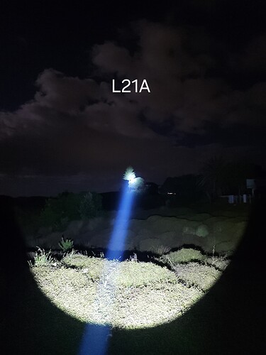

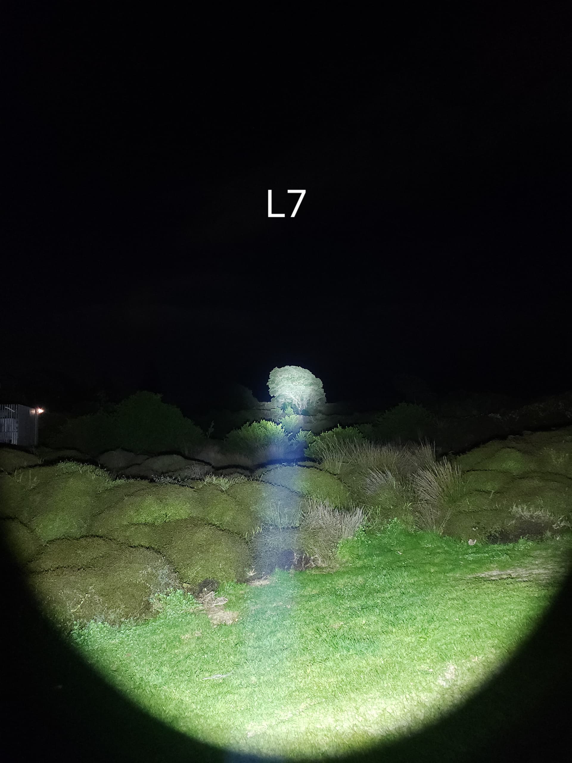

Hi guys , new here and starting to get a few lights. Thought these comparison pics might be if interest!
Photos are labelled and I set white balance at 5000k
Nice shots!
For the future, try to make sure the camera settings such as exposure are the same. The sky is much brighter in the SFT25R beams, indicating overexposure relative to the SBT90.2.

Tight beam on the L21A! It’s like a searchlight.
L21A is being driven pretty hard. 8A driver?
Yep 8amp , it’s a real beast.
I could tell by the color of the spot and spill shiftinf very cool, almost blue. The only thing keeping it alive is the thermal mass of the host. It’s not advisable to drive it over 5-6 amps otherwise.
