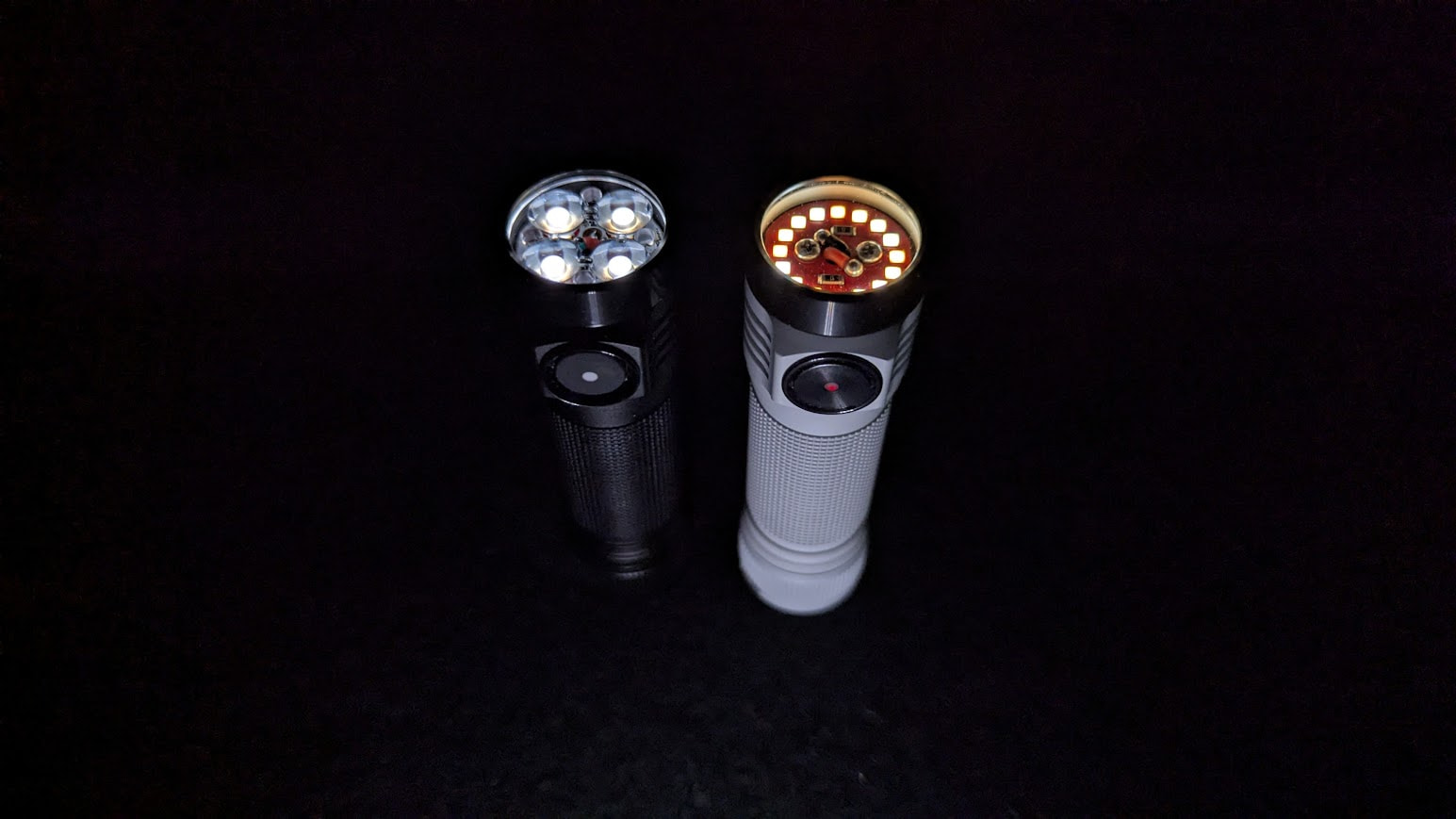

I also have Darth Vader and Stormtrooper themed lights.
I’ll try to get a better pic of these later
