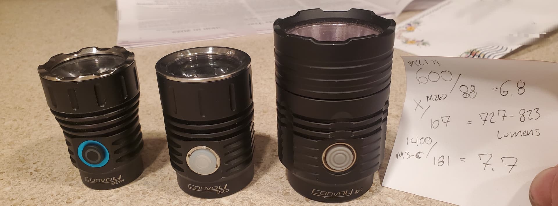

So if we can pretend that the runtimes here are all proportional to the weight of the head of the flashlights I measure;
(only measuring weight. Using provided lumen measurements.)
M21H 88g - 600 lumens(with potting material so slightly heavier, covering exposed driver components)
M26D 107g - ~720 - 820 lumens predicted
M3-C 181g -1400 lumens
The M26D isn’t nearly as large as the M3-C and if lumens sustained is proportionate to weight of head and it follows the same ratio as the others you have examples of it should sustain 720 - 820 lumens if emitters are all equalized.
