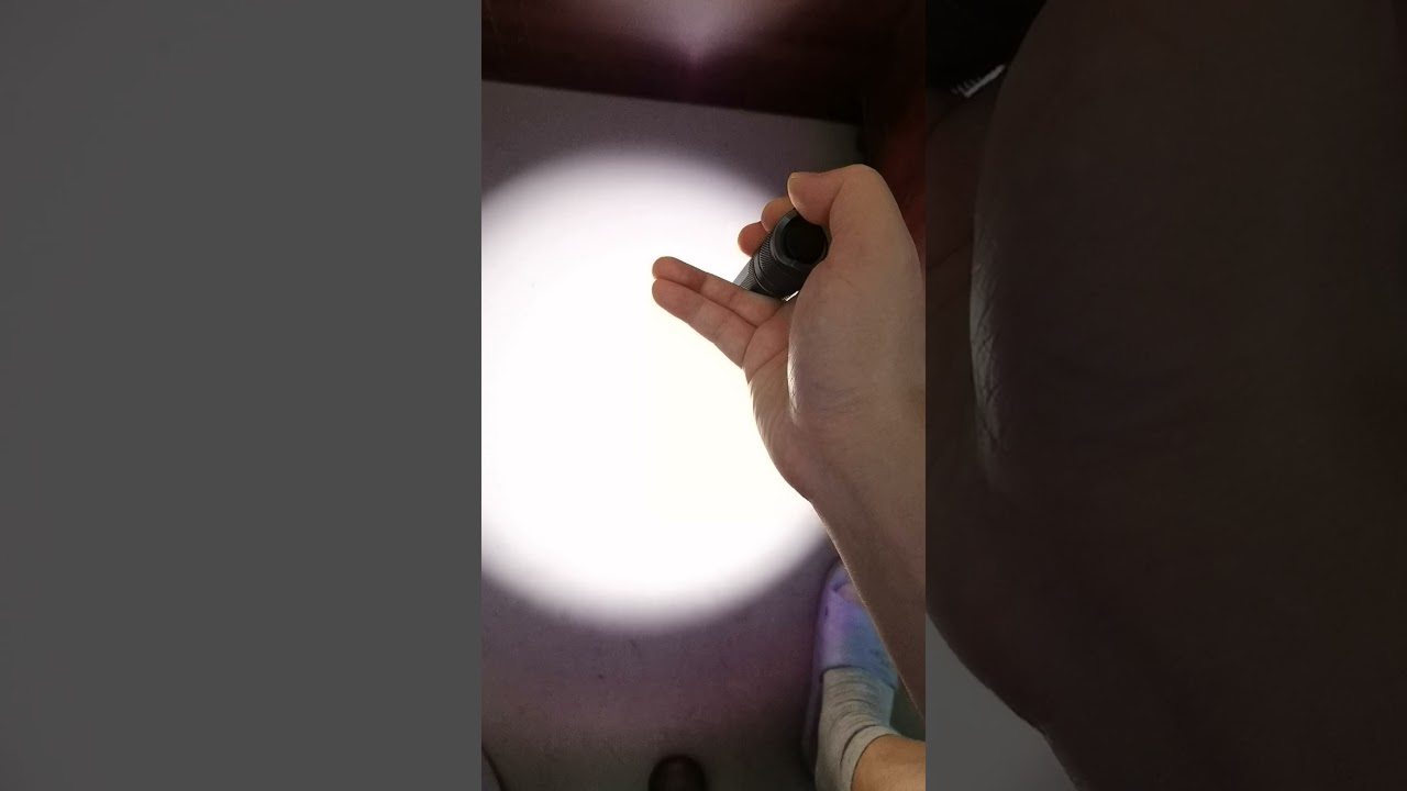

Here's a video that make it looks really easy.
(The video is not in English, but if you understand how the driver works, that's not a problem.)
It took me about an hour of trying and trying again just to enter config mode (and therefore get my flashlight configured the way I want it.)
That is inexcusable.
I think that I might have received a dud flashlight driver because most people don't have the trouble that I did, and my flashlight did not behave in the same manor as in the video above.
