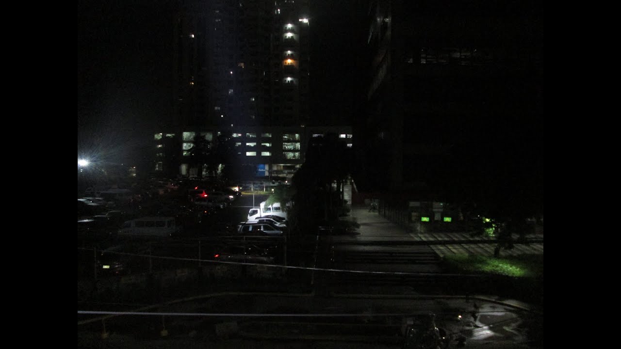

At farther distances, the difference is even clearer
(flashlight to opposite building around 150 meters / 400 feet)
Convoy S21B (Osram PM1) beamshot
www.youtube.com/embed/t-_iHYU0mHA
Noctigon KR1 "W2" (Osram PM1) beamshot
