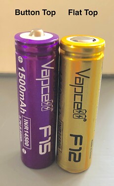

I have the Wurkkos HD12 with Vapecell F15 (flat top, I thing it’s called) and the Convoy T6 with H10 (button top). I thought of using HD12 as a charger for T6. It works, as the HD12 takes and charges both.
But the flat top F15, which worked for a few minutes in the T6 doesn’t want to power T6 anymore. H10 works fine. I suspect the ‘flat top’ may be the culprit.
Is that how it is supposed to work?
It says on the Convoy website that the T6 is only compatible with button top batteries so I’m surprised a flat top worked at all.
That’s ‘flat top’?
FTs may or may not be “flat”, depending on the wrap. Sometimes it protrudes juuuuuuuuuuuust enough to make contact, especially if squished down by the rear spring.
Other times, the wrap is juuuuuuuuuuust thick enough to keep the center from making contact.
Just for “testing”, I used a single FT in a Q8, and the slight twisting of that contact ring was enough to make decent(-enough) contact with the cell.
I wouldn’t use it with multiple cells in parallel, though, because if, say, A makes contact and B doesn’t, the A might run down to 3.0V and B stays at 4.2V. One wrong jiggle, then B suddenly makes contact, and now you have a crowbar across the cells so that B current-dumps into A for both voltages to equalise… Very Very Quickly. :fire::exploding_head::fire:
yes :wink:

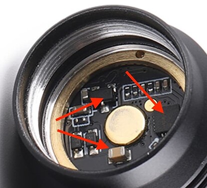

Convoy has components around the positive contact button in the head, that are taller than the positive contact button in the head.. These prevent contact if a battery is inserted backwards..
Convoy calls it Physical reverse Polarity protection..
although flat tops can also work, it is not reliable because the battery is being lifted by the raised components, and that sometimes prevents a flat top battery from making good contact:
you should plan on only using Button Top batteries in your Convoy T6
