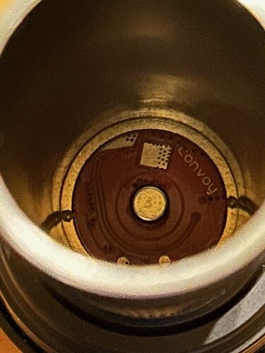

Post a picture of it.
You’ll need a Soldering iron and some solder.

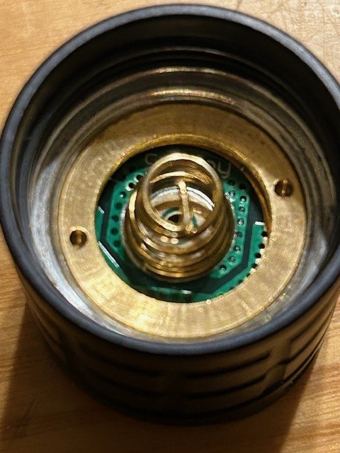

I’m not sure if you can see what you need to with these pics. If not, I’ll definitely try again. I’m guessing the driver is in the tail cap? I wasn’t sure so i took pics of the inside front as best i could as well.
Thanks again.
I think i’ve learned that the driver isn’t in the tail cap! but soldered to the emitter in the front. Is the driver the red object inside the tube?
Yes, the driver is the Red PCB.
That looks like the 8A Buck driver.
I haven’t had any issues with those, but the issue you are having seems like a driver issue to me.
