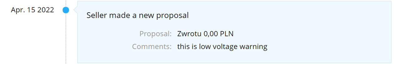

I think that the switch can’t handle 10A from turbo. The voltage drop cause low voltage warning. You can select mode group 9 and turn memory off to see if it works. Turbo only last for a few minutes anyway. I also find that the step-down from turbo is timed (10 minutes to 35). In the other hand, 50 seems to have temperature control.

So on every mode, it's not working correctly. Even on 50% the momentary button isn't working, so it will not working correctly on every group.That's not funny, do I sound irritated, well I am irritated.
If it can't candle 50% mode, then it wouldn't work properly on every convoy M21B. And it's a remote switch designed to work with the M21B, do you see the irony.
Will try to test it later with my new lab power supply, to see exactly how much current it can handle.
Ps. I bought it all in official aliexpress convoy store, without using convoy store discount code.
Pps. official aliexpress convoy store accept my dispute, so I didn't lose money. But well, I post it here to hear if somebody have the same problem with it. Because I had 2, and tested on 2 convoy M21B and they didn't work even on 50% power.
And I do want to buy it for my bike, but I have to know if it's working correctly, and i'm just unlucky.
Again it’s a low voltage signal.Probably the momentary circuit has a higher resistance. You must remember that it’s a mechanical switch. Let’s consider 1 Volt drop, at 5 Amps it’s only 0.2 Ohm.
