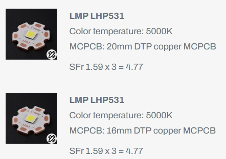

I put in a LHP531 5000K in a Sofirn SC29 and I love it so far, so I had to order a couple more…

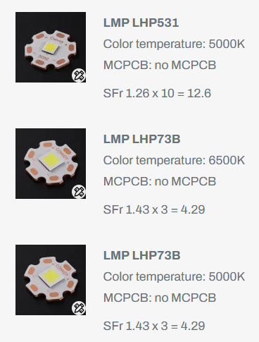

A week ago:
And another order today…
