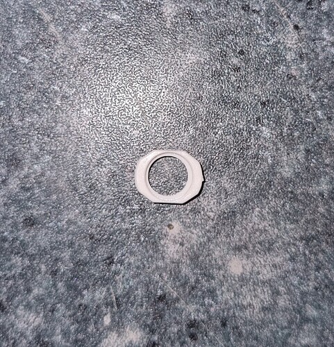

I had thought of that way back when thinking of ideas for my gasket, should have gone with that instead. It was easier to design my gasket with my limited ability in CAD software at the time.
